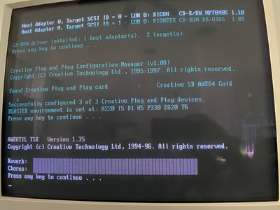

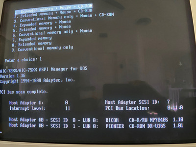

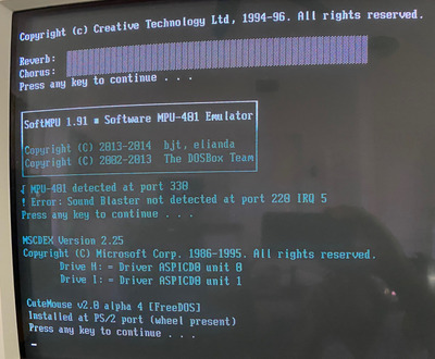

UPDATE:
I recently I replaced my IDE CD-ROM drive with a SCSI one, on an Adaptec AHA-2940UW PCI adapter. Whenever I boot the system, I get this error message:
MPU-401 detected at port 330
! Error: Sound Blaster not detected at port 220 IRQ 5
This is my current SOFTMPU.EXE entry in Autoexec.bat file:
LH C:\UTILS\SOFTMPU\SOFTMPU.EXE /MPU:330 /SB:220 /IRQ:5
Also the Blaster environment loads at is set at: A220 I5 D1 H5 P330 E620 T6
I haven't touched my sound card at all, I am not sure why I get this message. Any help would be appreciated!
PIII-800E | Abit BH-6 | GeForce FX 5200 | 64MB SD-RAM PC100 | AWE64 Gold | Sound Canvas 55 MKII | SoftMPU | 16GBGB Transcend CF as C:\ and 64GB Transcend CF D:\ (Games) | OS: MS-DOS 7.1-Win98SE-WinME-Win2K Pro (multi-OS menu Using System Commander 2K)
Reply 357 of 419, by C0deHunter
No conflict, I guess.

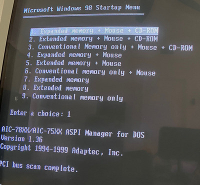

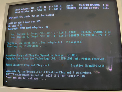

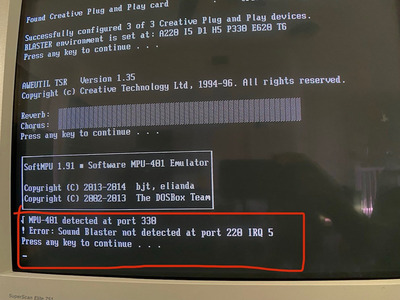

Reply 358 of 419, by C0deHunter
The error message.

Reply 359 of 419, by C0deHunter
appiah4 wrote on 2020-10-28, 23:14:
The SCSI controller probably shares a resource with the sound card?
OBSERVATION 1)
I just tested the system with Quake, and inserted the actual CD-ROM (has Trent Reznor's Red-book audio):
Both sound effects and CD audio works flawlessly.
OBSERVATION 2)
MUNT seems to be working fine, even with the SoftMPU error message.
