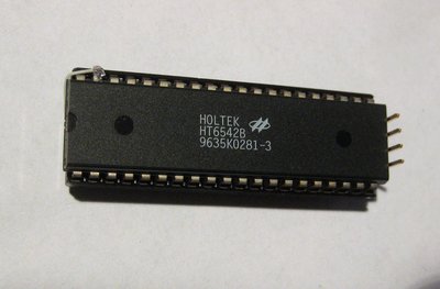

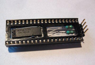

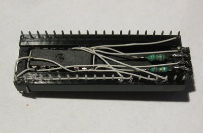

I have put the PS/2 mouse modification onto a removable socket so that I can more quickly test numerous 386 motherboards for PS/2 mouse BIOS support. I used surface mount capacitors and resistors, so you won't be able to see them in the photos. The green through-hole components shown are inductors (not resistors).
246.29 KiB
4488 views
258.1 KiB
4488 views
232.17 KiB
4488 views
If I were to do this again, I think it would be easier to simply epoxy the inverter IC on top of the Holtek keyboard controller and forget about the inner DIP socket. The purpose of the DIP socket here is just to make the final product look cleaner and allows for changing the keyboard controller chip.
