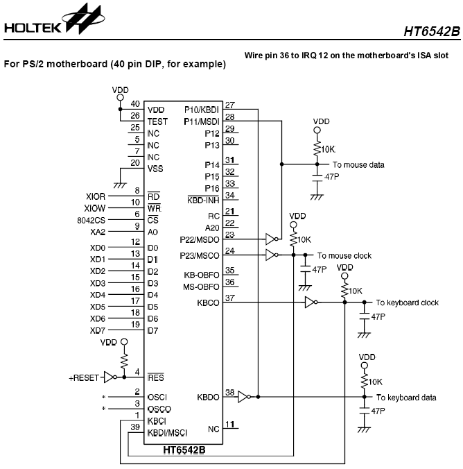

Reply 21 of 374, by feipoa
SiS 497 pin 8 should be connected to pin 36 of the keyboard controller (MS-OBFO pin). I hope this is the only missing link. On the DTK board, there is no connection here, whereas the 4DPS board has this connection made. I've had to pack my stuff for the weekend, but will re-test this as soon as possible.

Reply 31 of 374, by feipoa
The DTK PKM-0033S uses a SiS 496/497 chipset. There is not a single UMC chip on this board. The IRQ pins on the chipset are directly shorted to the IRQ's on the ISA slot, so I ran the wire to the ISA slot because they are both through-hole solders.
Attached is an image of the circuit diagram to implement.

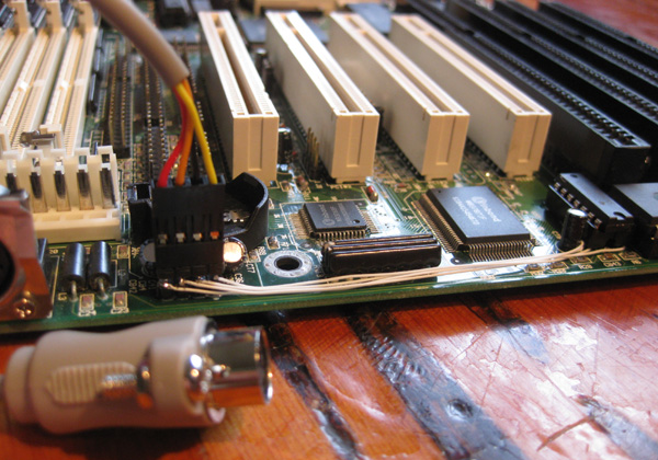

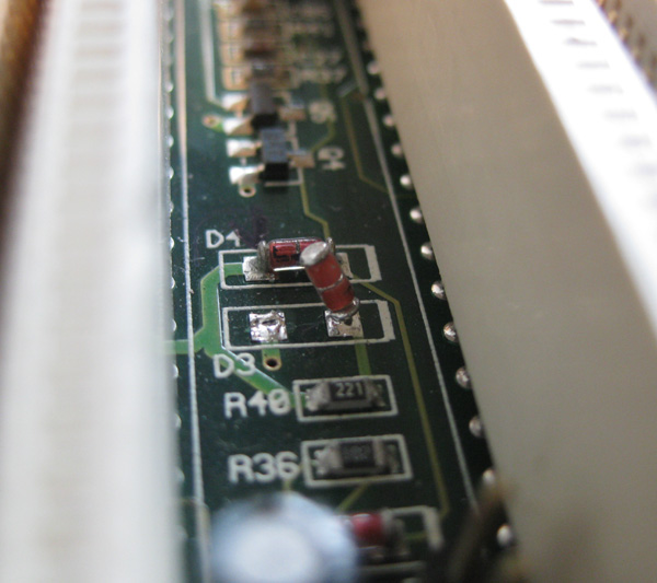

Reply 32 of 374, by feipoa

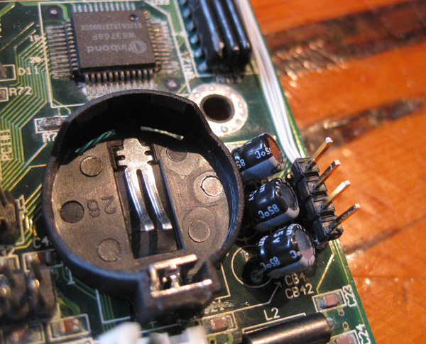

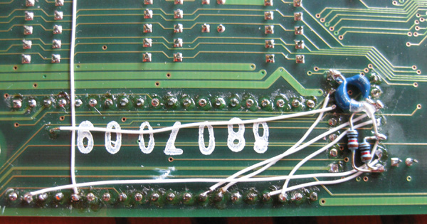

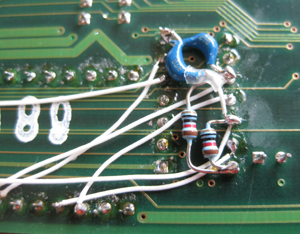

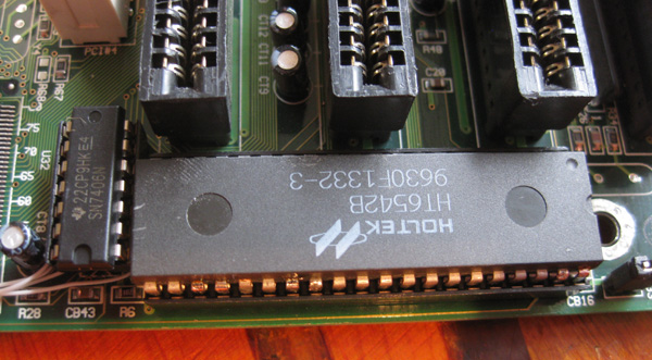

Here are some photos of the final PS/2 job. I wanted to keep the mess on the underside of the motherboard. I was able to use the existing 6-pack inverter IC on the board but had to insulate pins 9 & 10 of the IC so that they do not touch the motherboard through-hole contacts. The original design was to use use two inverters in series to create a buffer. The PS/2 design uses inverters only, so some pins could be re-routed to free up this inverter. I did not want to cut PCB traces, so I insulated pins 9 & 10 of the inverter IC and pin 39 of the Holtek keyboard controller. It is not obvious from the photos though.
DIP sockets were used for both the inverter and the keyboard controller. There is just enough clearance for adding PCI and ISA cards.
The PS/2 header is epoxied to the board's surface. The surface was scratched lightly with sand paper to improve adhesion.
There is an excess of flux on solder pins. I soldered/desoldered a few times before I got it the way I wanted it. I should get some flux cleaner.
A CR2032 CMOS battery was added. It pretty much fit right into the barrel battery through-holes. I just had to move 3 caps out of the way and lift up diode, D3.

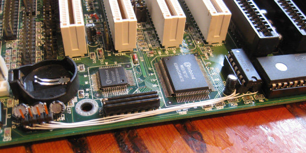

Reply 33 of 374, by feipoa
More photos...

Reply 35 of 374, by feipoa
I originally used a separate inverter package and did place it in the cubbyhole under the keyboard controller, but it still requires rewiring of the existing inverter and keyboard pins. Also, with the inverter under the keyboard controller, the keyboard controller would sit about 1 mm higher. This was enough to prevent full insertion of an ISA card. A little bit of mess on the underside of the motherboard doesn't bother me much.
With the second inverter under the keyboard controller, you can probably hide the keyboard re-routing wires between the keyboard controller and the PCB.
I'd recommend sourcing some SMD 47 pF and 10k-ohm parts to reduce the height of the sandwiched inverter IC. You may also want to source a 2-package inverter IC instead of a 6-package.
