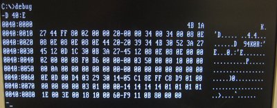

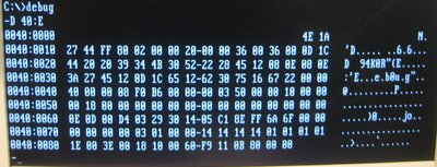

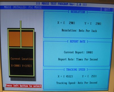

I tested my final PGA-132 based motherboard, the AMI Mark V Baby Screamer with AMI BIOS date 7/7/91. Of all my motherboards, this is the board I wanted the PS/2 mouse adapter to work in the most - it did not work! The TSR screen says that PS/2 mouse support is enabled and to run a driver. The driver loads and says that PS/2 mouse is installed, however, when I run test.exe and move the mouse, the cursor moves all the way down to the bottom left of the screen and both buttons light up (the mouse buttons on the screen). I can at least press ESC to exit test.exe.
Do you have any idea how to get the PS/2 mouse working on this motherboard? I have attached the debug screenshot. Unlike with the AWARD debug, I am able to exit debug on the Baby Screamer.
I also tried CTMOUSE version 1.9. It said that PS/2 mouse installed, then I ran test, but could not move the mouse pointer and the cursor went up to the top right. Could something else be using IRQ 12? Is there any program which can check for unused and used IRQ's?
I'm not sure if this is relevant, but the AMI Mark V Baby Screamer is my only board which uses two EPROM chips for the BIOS - one EVEN and one ODD.
Using my multi-meter, I checked to ensure that the keyboard controller socket on this motherboard is wired the same as on all the other motherboards. It was wired the same. On the boards tested thus far, it seems that they are wired as follows:
KBC pin 38 --- 7407 --- KBC pin 39 & Key Data
KBC pin 37 --- 74F04 --- 7407 ---KBC pin 1 & Key Clock
On some boards, 74F04 is substituted with 74LS14, but both are inverters. 7407 is a buffer.

Reply 201 of 543, by Rio444
Please say, did you do debug screenshot before run TSR or after?
I need both screenshots to test one idea.
Also try Cutemouse ver.2.0 and 2.1 and other mouse drivers.
Maybe their will find some mistake.

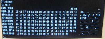

Reply 203 of 543, by Rio444
Rio444 wrote:
Could you view the contents of memory at 0040:000Eh using MS-DOS utility DEBUG? Run Debug and type on the keyboard 'D 40:E' Ente […]
Run Debug and type on the keyboard 'D 40:E' Enter.
And write here first four byte.
Do it before run the TSR and after.
However, if it is difficult for you, you do not have to do it.
Reply 204 of 543, by feipoa
Looks like I edited my post as you were responding.
It is not difficult for me. I still have the AMI Mark V Baby Screamer system setup on my test bed. I will rerun debug today.

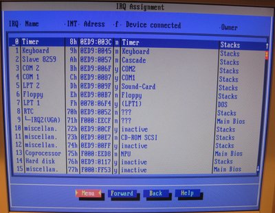

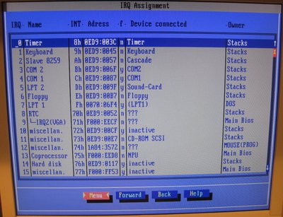

Reply 207 of 543, by Rio444
feipoa wrote:
MS-DOS 6.22
OK, it's good.
Check the status of the Irq12 using 'Dr.Hardware', after run the TSR.
Run Dr.Hardware, select "IRQ Assignment" and show, what you see.
Download Dr.Hardware here https://yadi.sk/d/K14UBHYx3T6GFs
P.S. You can check the status of Irq12 before running the TSR to make sure it is free.
0_25430a_af7ceb78_orig
0_25430b_da607f0d_orig

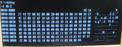

Reply 208 of 543, by feipoa
Enclosed is the requested information.
165.62 KiB
1477 views
Debug before TSR is loaded
164.69 KiB
1477 views
Debug after TSR is loaded
158.5 KiB
1477 views
Debug after TSR and mouse driver loaded

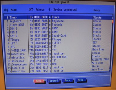

Reply 209 of 543, by feipoa
282.36 KiB
1477 views
IRQ assignment before TSR loaded
280.62 KiB
1477 views
IRQ assignment after TSR loaded
272.3 KiB
1477 views
IRQ assignment after TSR and mouse driver loaded
Reply 210 of 543, by feipoa
The problem has been SOLVED!
The AMI Mark V Baby Screamer is the most particular of all my 386 motherboards, and this is no exception. For whatever reason, and on this system only, I must load ps2suppc.com before running C:\WINDOWS\net start
I was able to load the Microsoft / IBM PS/2 mouse driver for Windows 3.11 and the PS/2 mouse works fine now.

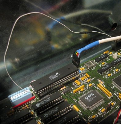

Reply 212 of 543, by feipoa
You connect pin 36 of the keyboard controller chip to IRQ 12 on the ISA slot by soldering a wire. You can solder this wire on the bottom of the motherboard if you wish, from through-hole solder point to through-hole solder point. You can also make a connector out of this wire.
I suppose I could sketch up a KBC inverter mod diagram, however, it will look similar to Rio's. We are using the same implementation, with the exception that he is using transistors as the inverters instead of an inverter IC. He is using a home-brew PCB, whereas I am using a DIP-40 socket and some 30 AWG wire. Now that I've gotten this working in my favourite motherboard, I will be making another ps/2 mouse adapter, so I can try to sketch up something at that time. I doubt it will be much different than what Rio posted though. Perhaps some explanation to accompany the diagram? I'm not sure when I'll get around to my 2nd adapter.

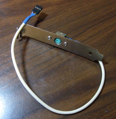

Reply 219 of 543, by feipoa
I went looking for a PS/2 mouse slot cover cable w/header, like those found commonly in the mid-90's. I could not believe it was going to cost me $25 to get one shipped these days. I remember buying these in bulk around 2003 for next to nothing. Supply and demand I guess.
So I decided to make my own. Maybe some of you find this useful. I desoldered a PS/2 mini-DIN-6 off of a dead motherboard. Took a slot cover (this one already had a hole) and scratched up the surface around where I would use JB Weld to glue the DIN to the slot cover. The glue holds better when the metal is more porous, so I scratched it with rough sand paper then with a sharp edge. The rest is fairly obvious - got some shielded 4-wire cable and soldered it to a header and to the DIN. The nut and bolt is for attaching the shield to the slot cover.
In the last photo, you can see that I connectorised the IRQ 12 line. It is the small white wire with black heatshrink in the middle (the connector). This way I can pull it out and test the KBC module on other motherboards. It may be fine to leave the KBC socket wired to IRQ 12 irregardless of whether you are using a PS/2 mouse or not, however I have not determined if this is OK in the case whereby you do not have a PS/2 mouse installed and you want to use IRQ 12 for another piece of hardware. You could test for that.
