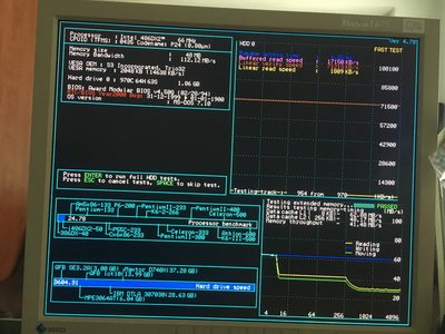

on my 486/66 tekram : 71MB/s 😀
mb asus sg2gx4, 256c-15 wt (wb mode is slower on all my vlb boards, dont know why....), 3x16mb fpm -60, bios at max speed settings, stable
cpu 486dx2-66s wt, vga vlb s3 trio32 2mb diamond stealth se, vlb cached ide propably tekram DC-680T (look exact like 680t) with 4mb, 16mb also tested...
