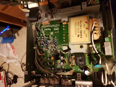

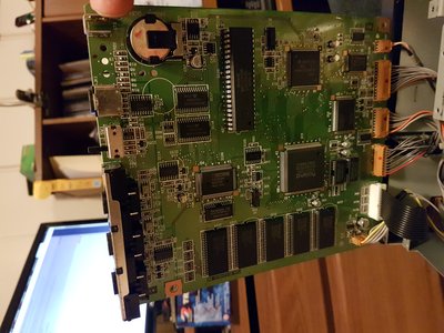

Reply 167 of 418, by fitzpatr
Well, as expected the SC-88Pro also had a battery. I needed to remove the screws holding the main, upper board before I could access the battery to remove it.
I should add that the battery was showing very early signs of corrosion. No issue now, but as always, it is better to take the precaution.
    3.81 MiB
    4369 views
    Roland SC-88Pro Main Board
    4.76 MiB
    4369 views
    Roland SC-88Pro internals.
MT-32 Old, CM-32L, CM-500, SC-55mkII, SC-88Pro, SC-D70, FB-01, MU2000EX
