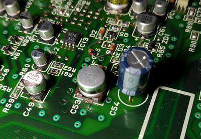

Reply 268 of 418, by imi
Not a SC55 and not a battery... but there are other things that can leak too 😒
The Korg AG-10 I got wasn't working, it receives MIDI data but doesn't output any audio, luckily the seller was honest enough and refunded me the money, I poked around a bit to see if I can find anything and well... this doesn't look too good:

imi wrote on 2021-03-31, 00:37:
Yeap, looks similar to what I found inside my SD-20 when it wasn't outputting any audio from the RCA jacks or headphone jack. It would only work through TOS-link which was okay, but I wanted it all working. Replaced out the caps when I found a few with grey and dull looking solder compared to the other components and knew then, that the caps had likely leaked and were starting to corrode the solder joints. Replaced them all out with standard radial electrolytic nichicon's I had on hand and it has been good since.
someone might have tried to change the caps at one point, think this is how that unit is supposed to look like: https://www.wavetable.nl/wp-content/uploads/K … nals-scaled.jpg
and what's with that unsoldered diode?
Reply 272 of 418, by imi
interesting, looking closer at that picture though shows some differences in the board, so probably a different revision, the diode might have been a factory botch job, who knows... if you look closely you can see that in place of the botched diode there is a "ZD2" on the board directly, so I assume that was a fix before they made a new board revision.

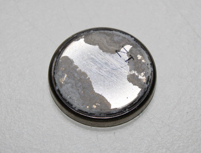

I opened my SC-55 for the first time today and it was probably at the last minute....

Reply 278 of 418, by pc-sound-legacy
I have to admit that it was new to me that liion cells tend to leak, too. Haven't had any issues with them on mainboards so far. But for some reason, in these modules or seems to be not uncommon. Have checked my modules as well. Most were ok but the one in my Roland RA50 was start leaking, too. (Luckily there was no damage so far - is lithium less agressive than the acid from the NICD/NIMH type cells?)
Reply 279 of 418, by 32kofdata
Got a SC88 last week and decided to open it up for cleaning. Battery had a thin layer of crust - just a matter of cleaning the battery holder with a brush and put a new fresh battery. My experience is that some tend to leak some don't. Might have to do with usage and probably heat and humidity.
