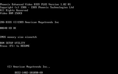

Its a standard ROM, HI/LO in one file. Works in an EMU. Your ROM is OK 😉 Remove the battery please 😉

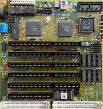

Reply 24 of 44, by scorp
keropi wrote on 2013-09-13, 17:40:
^ good thinking, will back it up , I do have a willem programmer , thanks for the tip because once it's dead the mobo will be useless...
Hello keropi. sorry for for reviving this old thread, but I got the very same mainboard SNB-M008 or GSH286, whatever the right name is. It had some damage because of a leaking battery, so I had to fix some traces, but now it works somehow. I replaced the SIPP memory slots by SIMM slots, because I didn't have any SIPP memory modules. However, the mainboard starts with only 640KB of memory. I already tried to remove the DIMM memory and used SIMM only with 4x1MB modules, but with the same result. Only 640K RAM is detected. Do have an idea? I tried the jumpers all to 1-2 and all to 2-3 position, but this doesn't seem to change anything. What does this 4MB vs 5MB written on the PCB mean anyway? What do I have to setup, if I want to have, let's say, 1MB in DIMM and 1MB in SIMM? Any ideas?
I also couldn't find the ROM, did you upload it somewhere? May be I could try yours? Who knows...

Reply 28 of 44, by Anonymous Coward
Sounds to me like the extra memory just needs to be configured.
Reply 29 of 44, by scorp
Anonymous Coward wrote on 2020-02-02, 02:58:
I'd think that too, but you can't configure much here. There are several jumpers in a row, which you can set either to 4 or to 5MB at once, that's it. And I tried already both variants. The mainboard just uses 640KB. Meanwhile I am pretty sure, that the BIOS, which was on the mainboard is not the original one. I peeled the sticker from it and it is an EEPROM from year 1991, but on the sticker I can read 1986. It is quite suspicious that the sticker is 5 years older, then the chip underneath, isn't it? Furthermore, the sticker looks like it was already peeled off back in the days, as I mentioned before. And the next thing is, that the flash chip is an EEPROM, which is absolutely not usual for that time. As far as I know, usually EPROMS were used in the end of the 80's.

I also think it just needs to be configured in the CMOS. Is there an option available to enter the ext. memory size?
I would also suggest to try the program testext (testx.exe). It will show you the RAM that is installed behind 1 MB and ignores what the BIOS reports.
Reply 31 of 44, by scorp
In the BIOS you can't setup much, at least I can't see any memory settings options. I'll give testx.exe a try, didn't know about that, thank you. However, if anyone has original BIOS for this mainboard, I would be glad to have a copy.
My Youtube channel Necroware
Reply 32 of 44, by scorp
Ok, some very strange thing happened. I booted into DOS without HIMEM.SYS or anything else except pure command.com. Then I started the testext.exe as suggested. It showed also no extended memory on the top, but during the run the program aborted with a "memory protection error" and some registers information, leaving the system hanging hard. After a reset the mainboard instantly counted above 640K up to full 5M, without any action from my side. Now I can insert/remove/change memory modules, all between 256K and 1M each without a glitch. I left the mainboard disconnected from power for a night and still, everything is detected properly. I have no clue, what happened there and I don't believe in magic, especially, when talking about computers. Any ideas?

Reply 34 of 44, by scorp
Predator99 wrote on 2020-02-03, 13:41:
I really like testext but its new to me its able to fix a broken PC...
What happens if you start it now? All 5MB RAM detected and Ok?
Sorry for late answer, I just wanted to test it over some days. It is kind of magic to me, but yes, it works now as it should. All 5MB RAM are detected if I set the Jumpers to 5MB. If I set them to 4MB, DIP memory chips are not detected and I get 4MB RAM. I even tried other combinations 1MB DIP + 1MB SIMM (4x256KB) works also. In case someone is interested, the 4MB/5MB jumpers actually seem to mean "SIMM/DIP only" or "Both". I got now all kinds of configurations through 1MB, 2MB, 3MB, 4MB and 5MB. The odds are when both type of memory is used DIP and SIMM together, the evens are SIMM only. Except 1MB, this can be either one of them at a time. Sizes bellow or between of full MBs seem not to work, so no 512KB or 1,5MB possible.

Reply 38 of 44, by scorp
Sorry for the late answer, I had to search for the mainboard in my stock. I finally found it, but yours is missing an IC 74F74 in the socket near the jumper 3. My board looks like this: http://www.amoretro.de/2013/11/jet-electronic … ld-chipset.html. There are actually barely jumpers on it, one row to select DIMM and SIMM mixed usage, one to set color/mono display, one to select internal or external battery and it is mostly it. The place for additional oscillator is also free and one jumper near it is hardwired. Why don't you just put an FPU into the socket and see if it just works? In the worst case it will be overclocked, but you can measure it on the pin and try to figure out, what to do on demand.
And you should really remove the battery ASAP. It already leaked heavily and it currently eats the traces. If you don't remove the battery and clean the mainboard now you will soon not need any jumpers settings anymore.
Reply 39 of 44, by RiP
scorp wrote on 2020-05-19, 15:59:
What is IC 74F74 for? and would you specify those jumpers?
