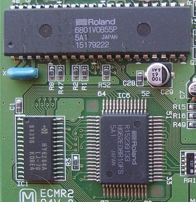

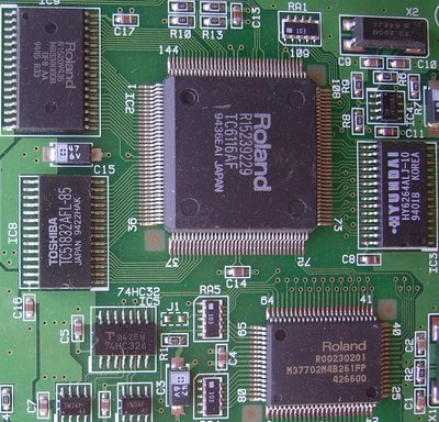

Thanks a lot. BTW, please can someone tell me what the ICs are, on the Roland SCB-7, and also on the Roland MPU401-AT card. Thanks.
781.28 KiB
710 views
Roland MPU401-AT 8-bit host card, ICs.
1.71 MiB
710 views
Roland SCB-7 wavetable sound daughterboard, ICs.
Reply 24 of 32, by keropi
I can answer the 401AT question - I think correctly 🤣
- top is mcu
- bottom left some work sram
- bottom right a bus interface chip
Reply 26 of 32, by realoldguy23
retro games 100 wrote:
Thanks a lot. Re: the SCB-7, I wonder if the two smaller Roland chips contain the 4MB ROM (2MB each?) wavetable sound sample set?
The Roland chip on the top left (IC9) is most probably a ROM. The one on the lower right is most probably not. I've never seen ROMs with 80 pins. I'd think it is the bus interface chip.
The Toshiba and the Hyundai chips are both SRAMs.
The board was produced in 94, all chips have 94 date codes.

Reply 29 of 32, by Cloudschatze
Question about the SCB-7: does it have a 16 or 18 bit DAC? ... Is the SCB-7's ROM 2 or 4 MB in size?
IC10: NEC μPD6376 - 2-channel, 16-bit DAC
IC9: Fujitsu MB838000B - 1 MB Mask ROM, with 2 MB-equivalent (companded) content
