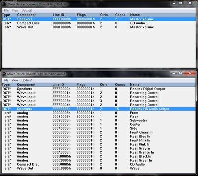

I wonder what HardwareAudioMixer compatibility shim does, which was also brought up in that thread.
Since Windows Vista the classic win32 multimedia mixer API's behavior changed radically. Any applications that do not use Vista+ specific APIs but the classic mixer API has no other choices but use a per application waveout volume(the CD output is a fake one and controls the same per application volume). The API does not expose any other output controls anymore so the windows mixer API is practically useless if you want to control anything but wave volume. E.g. the HW Midi volume of SB cards or the playback volume of Mic/Line-in (not the recording inputs!) are unavailable through the mixer API.
The only solution to this problem is using Windows XP compatibility mode/HardwareAudioMixer compatibility shim. This way the application can access the real mixer topology of the sound hardware.
Upper picture: Mixer without compatibility shim. Lower picure: Mixer with compatibility shim.
