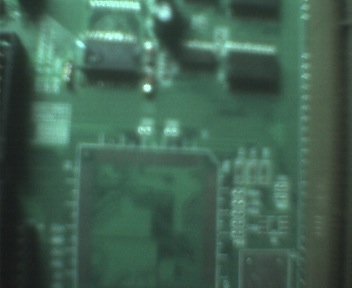

Found 'em! 😁
I think these are the drivers I remembered.. I don't know whether they can be called "mouse drivers" (or mice drivers), though.
- Some time ago I came across them, as I attempted to use USB mice with an MediaGX computer lacking legacy suppport (no PS/2 emulation).
But unfortunatelly, these drivers weren't compatible with the on-board USB host controller.
So I ended up adding some SMD parts to the mainboard and restored the serial interface. ^^
Anywaym, I can't say whether they are functional or not.. If you want, just try them and give feedback!
I'm still curious. How do they work ? Do they provide PS/2 emulation for another mouse driver or are they stand-alone ?
