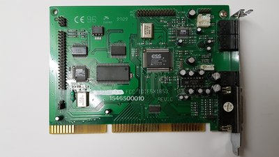

Bought this card for a very small price from ebay. It is the low profile version.
I like the FM sound a lot, but I have issues in games like Tomb Raider and Screamer 2 as this card seems to be incompatible. I use this card on my new socket 7 project and I'm really disappointed. Will check more games and if problems persist I might throw in another card.
edit: 🤣 I found out that there was an IRQ conflict with a printer port so I changed the settings and everything works fine!

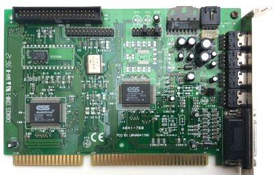

Since this seems to be the ESS ISA general discussion here, I have some remarks and a question regarding an ES1688/968 based card. Picture is attached.
I would expect this card to work with the same ESSCFG as my other ES1688 card, but that gave only partial success. On a PnP enabled motherboard it indeed gets recognized by the usual ESSCFG, but on my 486 motherboard it says "Unable to find ES688, ES1688, or ES1788" every time.
Now I found out about the existence of a file called ES968.COM, and did some searching. There are DOS drivers around with ES968.COM included and although Device driver ES968.COM is seemingly not mandatory, the ESSCFG file that accompanies it does recognize my sound card. Like this ESSCFG on this FTP server which is labelled "2.8 for ES968 + ES1688". Works fine now: SBPro Digi, ESS Digi, FM Music, Midi Music (with DB) 😀
MWMENU.txt on the same FTP server says this:
ES968.COM is a device drive to initialize the sound card. ESSCFG.EXE is a utilities to configure the sound card paramet […]
ESSCFG.EXE is a utilities to configure the sound card parameter.
ESSVOL.EXE is a utilities to configure the volume of the sound card.
ES968.COM utilities is needed to initialized the sound card to
enable or disable the on-board secondary port IDE interface.
After this installation, please edit the config.sys and ensure
that the ES968.COM is loaded before the ATAPI CD-ROM MSDOS driver.
Ensure also that the parameter /c:e is used.
There are no configuration jumpers on this particular card. According to Stason.org the CN3 header next to the wavetable header is a mixer expansion interface. This is also kinda strange since the ES968 mixer expansion is already soldered on. I suppose that is why these two jumpers are on CN3.
The remaining question is, are the ES968 mixer enhancements usable in DOS?
