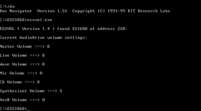

Interesting. I looked into it further.
ESS Vol is 8 on boot
29.33 KiB
704 views
On Boot

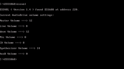

If Lands of Lore is started with the intro it's 12 (talking about turning volume up to 11), synth is even upped to 14
22.66 KiB
704 views
After LOL Unlocked
I then tried with midito lock
ESS Vol 8 on boot
MIDITO Lock
Lands of Lore normal -> Ok -> Quit game
Lands of Lore Intro -> Sound broken -> Going into the game -> Sound still broken
ESS Vol still on 8 if I start ESSVOL, BUT the volume is not 8, it's higher.
You can clearly hear that in my recording I just did:
https://youtu.be/vNt0KRUAyhY
So it looks like that on the surface the mixer volumes are kept, but internally, it's still changed.
92.76 KiB
682 views
Reply 287 of 314, by Falcosoft
Kordanor wrote on 2024-03-19, 10:47:
Interesting. I looked into it further. ESS Vol is 8 on boot OnBoot.png If Lands of Lore is started with the intro it's 12 (talki […]
ESS Vol 8 on boot
MIDITO Lock
It is really interesting. Have you tried to load a saved game after starting it? If I remember correctly in case of protected mode games MidiTo has to apply some tricks to restore mixer settings. And the trick is to re-apply settings in case of disk activity:
Re: MIDIto - relocate hardcoded port 330h to somewhere else
And if you use UNISOUND then everything works as it should? I mean ESSVOL shows the same values but the sound is OK?

ah, you are right. Going back into dos seems to reapply the old volume, ofc that doesnt help much.
But now I need to recheck whether I did miss that with UNISOUND, but if I remember correctly it kept the sound ingame as well without quitting. But will recheck tomorrow.
Reply 289 of 314, by Kordanor
Ok, tested UNISOUND again, but I remembered it correctly. In difference to the Original ESS Driver, the settings in UNISOUND keep locked.
As you could see in the video I posted before with ESS the volume is reset when playing the intro even if it is locked. Once the intro is starting the intro is loud and the actual game then stays loud. (And in DOS the settings are then reset)
With UNISOUND on the other hand, that doesnt happen if it is locked. Even the intro will be played in normal volume. Nothing changes from what I can tell.

Ok, I did some further testing, and it seems like it is not the Unisound. Because once you start modifying different sub-values you run into the same issues.
But then I seem to have found the solution. MIDITO -lock doesnt actually lock everything, but only a couple of things. So what you would need to do is to run MIDITO -lock=XX,YY and then basically every parameter.
