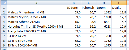

Made a long video card benchmark run with my new build-in-progress, AMD 5x86 -133 on Acer AP43 (SIS 496/497).
Matrox Athena showed the expected poor DOS performance; however I expected better from V2200. S3 videocards show impressive scores yet I was confused when 64V+ turned out to be slower than 64, given that 64 has 60ns EDO ram and 64V+ - 45ns. S3Trio 3D/2X has the best score of all S3s, yet I expected it to slightly outperform Millenium II and ET6000. Well, it didn't, despite SDRAM and being manufactured in 2000.
The top scores are achieved with Matrox Millenium II, S3 Trio 3D/2X, ET6000, Matrox Mystique, but ET6000 did not work in DOS text mode, so Doom score is unknown. We see almost equal scores: at this point, the CPU is no longer bottlenecked by the videocard.
P.S. I'm adding Millenium II score into the list. Are the other scores worth adding? It would create confusion if I added V2200 and Athena scores there; S3 scores are more or less identical; ET6000 is inconsistent.
