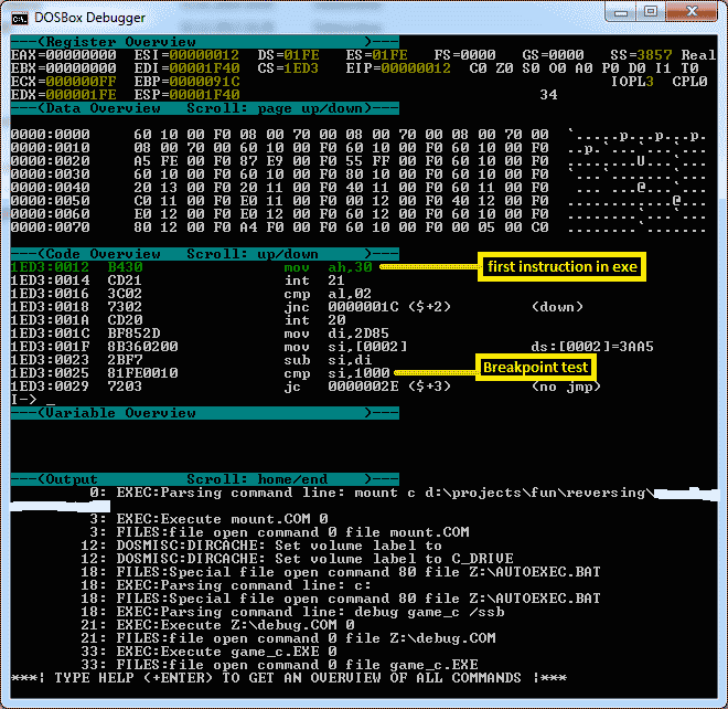

i think i've found it - seems to be a regression with the bp-cmd or the break point handling
i reduced my testcase down to a small screenshot
14.65 KiB
2030 views
it works if i set a breakpoint using the dosbox shown segment/offsets
but if i use an segment/offset pair that points to the same 32bit location but using different segment/offset values
dosbox will only colore the line red but will not halt on pressing F5
in debugger:
BP 1ED3:0025
- line gets colored red
- F5 stops on 1ED3:0025
convert 1ED3:0025 to 32-bit offset and convert back to 16-bit segment/offset
BP 1ED5:0005
- F5 does not stop on 1ED3:0025
i can use "C 1ED5:0005" without any problem to get to the code
this is how i produce a non-working but stilll valid segment/offset out of the dosbox shown segment/offset
int offset32 = 0x1ED3 * 16 + 0x0025;
int my_segment = offset32 / 16;
int my_offset = offset32 % 16;
assert(offset32 == my_segment * 16 + my_offset);
//dosbox-ptr: 1ED3:0025
//offset32: 0x0001ed55
//my-ptr: 1ED5:0005
the problem is that i generate BP positions from other source not following the dosbox schema - but that shouldn't (of my understand) be a
problem at all
i've added a simple nasm hello.asm and the resulting hello.com to reproduce the problem
    dosbox_bp_regression.7z
    267 Bytes
    80 downloads
Reply 3 of 9, by ripsaw8080
Rank DOSBox Author
DOSBox Author
Physical breakpoints look for an exact match of the specified segment and offset. It's been like that as far back as 0.60 (I didn't check earlier), so how is it a regression?
This change to debug.cpp will allow breakpoints to stop at the same effective address at the cost of additional computation per executed instruction:
-       if ((bp->GetType()==BKPNT_PHYSICAL) && bp->IsActive() && (bp->GetSegment()==seg) && (bp->GetOffset()==off)) {
+ if ((bp->GetType()==BKPNT_PHYSICAL) && bp->IsActive() && (GetAddress(bp->GetSegment(),bp->GetOffset())==GetAddress(seg,off))) {
It could be better optimized by storing the 32-bit address in the breakpoint object and only computing the address on the currently executing segment and offset.

Ah, the address is already being stored, so the more optimized change is:
+ if ((bp->GetType()==BKPNT_PHYSICAL) && bp->IsActive() && (bp->GetLocation()==GetAddress(seg,off))) {
I'll test it like this for awhile to see if there are any issues.

@ripsaw8080 - thx to your fix - now all my former not/partial working breakpoints work now
but still the red line is sometime not shown on the breakpoint line (seem to be something similar)
i've found this code in debug.cpp responsible for the red background - and it seems to be correct, maybe my exprectations are wrong
} else if (CBreakpoint::IsBreakpointDrawn(start)) {
wattrset(dbg.win_code,COLOR_PAIR(PAIR_GREY_RED));
Reply 9 of 9, by ripsaw8080
Rank DOSBox Author
DOSBox Author
I've noticed one drawback with this change to the debugger: breakpoints intended for when the processor is in protected mode won't work if set while the processor is in real mode, and vice versa. Before the change it didn't matter if a segment or a selector was specified. This could be resolved by adding something like BPR (real) and BPP (protected) commands in the debugger that aren't based on the current processor mode, but the BP command and F9 key would still use the current processor mode. Not sure if it's worth the trouble, though.
