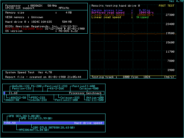

Has a 386 ever scored so high in speedsys?
    6.9 KiB
    2193 views

Ah awesome. That would surely help. I've found and ordered a bit faster RAM so in the next weeks or so let's see what i can achieve. The performance gain seems to be good at least, usually a 386DX-40 with no FPU scores between 9 and 10, so i find my score of 11.68 to be very encouraging. I suppose a 486DLC 33 scores around this value as well.
