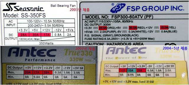

Reply 23 of 40, by ik777
For the stance of power supply, there's no PSU both support great PCI-Ex graphic card with -5v supply for ISA slots.
The time old PCs which was commonly support V,I,P slots had very poor +12V supply. (less than 10A)
When the AGP come out, +5V supply was increased and CPUs are used +12V2 mainly.
After PCI-Ex graphic cards, +5v supply again decreased and nowaday PSU generates mainly +12v supply, but not generate 3.3V or 5V as before. (30A->20A)
These PSU will support ISA and old device flawlessly, but never support both Core2 or 4 CPU & Graphics. Put on newer PSU, what for ISA devices?
