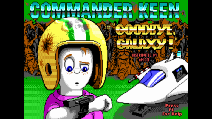

Basically that would be a variation of the overscan border patch, with all of its pitfalls. There could be five overscan choices; here is how they would look on a 16:9 widescreen display
  1. no overscan at all, which is what DosBox currently does
    227.72 KiB
    1202 views

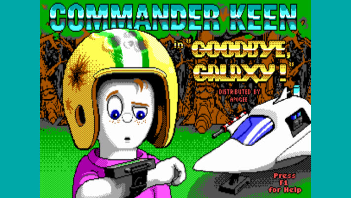

  2. full 4:3 overscan, as much as the emulated video card generates, calculated on CGA by subtracting Horizontal/Vertical Displayed from (Horizontal/Vertical Total minus Sync), slightly more complicated on EGA/VGA
    230.46 KiB
    No downloads
