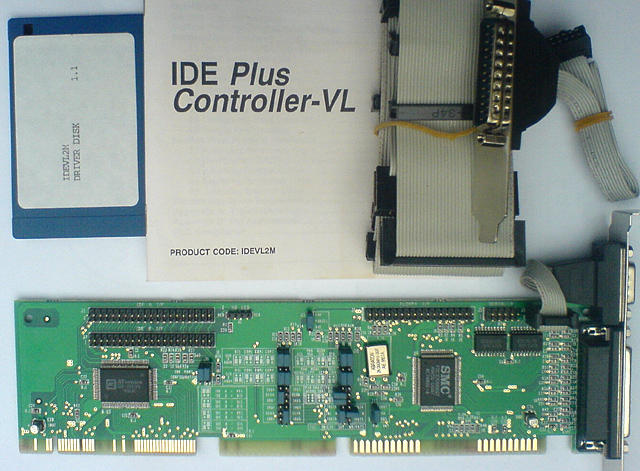

The new video card was of zero use for weeks, since the existing UMC Multi-IO+VGA controller cannot turn off its VGA part. It can only turn off the IO modules. This left me with no harddisk access when the CL-GD5428 was installed. At most I could verify it posted.
Yesterday this was solved by the arrival of a new Multi-IO card. Quite a nice one: IDEVL2M with ATronics-2015PL chipset. It is brand new in the box, with cables and documentation. It matches the offering from Boca research. They are still around it seems.
227.88 KiB
5782 views
Chipset: ATronics IDE-2015PL; week 03 1995

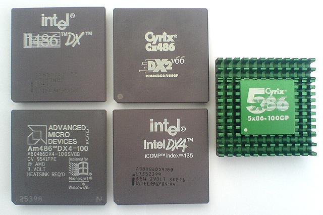

Before that I also read about the Cyrix 5x86 being able to do 1x multiplier. This would be very useful, as the 486DX4s are hard to slow down sufficiently for some older games. Death Track for example.
At first I feared such a CPU would not properly run on a mid-generation 486 motherboard, but some people here suggested it should.
Anyways; eventually found a Cyrix 5x86 100GP S1R3 for a reasonable price. The modded BIOS recognizes it properly, and it works very reliable so far. It remains close to the mighty intel DX4 in the graphics benchmarks. But the 1x multiplier is enough reason to replace the previously installed iDX4.
Cx5x86 support is planned for SetMul. Actually the development version does the trick already, but the CPU detection routines must be expanded before I can release it.

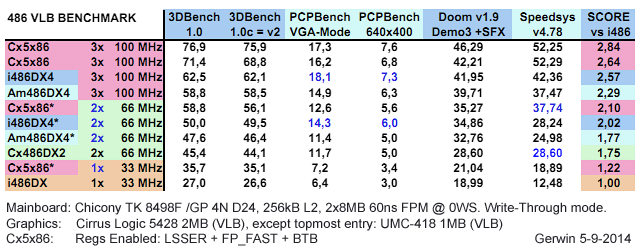

Yesterday I benched all the available CPUs and the two VLB graphics Cards. Using all possible multiplier settings and without changing a single thing in the BIOS or the startup configuration.
One thing about the UMC-418 graphics: It is like 7,3% faster then the Cirrus Logic. But considering its downsides, the CL-GD5428 is likely to remain installed. The UMC-418 scored 8,3 FPS in PCPbench when combined with the intel 486DX4-100 and 7,0 with the am486DX4-100.
The last SCORE column is just a quick and dirty attempt at normalizing the results to a single value: Done this way:
Score=((3DB1+3DB2)*0,35+PCPB1*2,9+PCPB2*6,57+Doom*1,08+Speedsys*0,96)/89,5
These scores are generally fine AFAIK. Take into account that Write-Back won't work properly with this motherboard, thus Write-Through mode was selected.
I have the feeling that of all the upgrades done on this system, the two 60ns FPM sticks were the best investment.

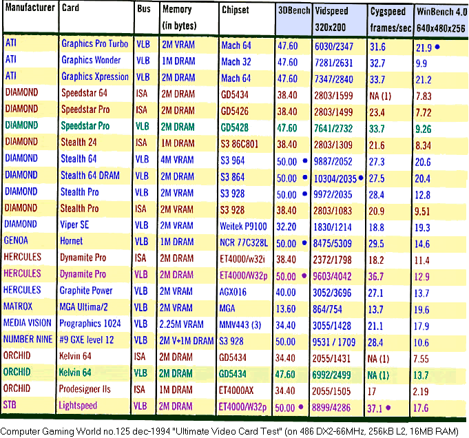

Here is a shrunk version of the Video Card test in Computer Gaming World no. 125 Dec 1994. The text colors are my doing.
160.12 KiB
5886 views
What is funny is the Speedstar Pro CL-GD5428 score, it is exactly the same as my card combined with the am486DX4@66MHz: 3DBench = 47,60 FPS. The exact same benchmark from 1994 was thus recreated in 2014. How useful is that 🤣
Looking at these scores, it shows that a CL-GD5428 is pretty close to what is the maximum framerate in DOS. At least for 320x200 mode. It is in windows that other cards can give a significant boost.

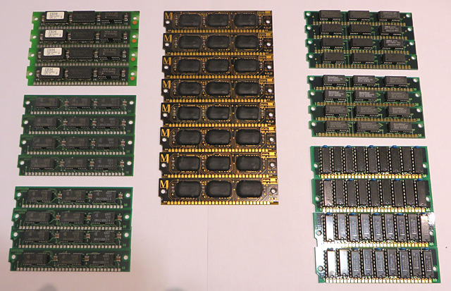

I got some extra RAM, but made a mistake.
Being 1MB 30-Pin SIMMs, they can only be combined with 4MB 72-Pin SIMMs. They will not combine with the current 8MB modules, like I intented to do.
Half the 30-pin modules are 60ns, the rest are the usual 70ns.

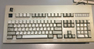

Past week I rearranged the storage attic. I took a better look at the yellowed keyboard belonging to this 486, and surprisingly it is actually a quality item: A Cherry G80-1000 HDU /05:
deskthority: "G80-1000 HDU (US layout, black switches, N-key rollover, beige |\ key)"
The black switches are probably of the 'Vintage' type. De keycaps are 'doubleshot'. Must try this myself, as I only used rubber dome keyboards up to this point.
