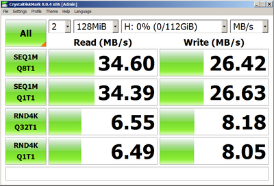

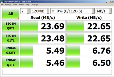

Some tests with the NEC D72010XF1 vs. VIA VT6912L.
System: SY-6BA+III, Tualeron @1.6GHz (133MHz bus, PCI 33MHz), RAM 1024 MB CL3
Testing an SSD with an NTFS partition using a SSD to USB adapter.
Got unexpected results!
NEC D72010XF1
Crystal Disk Mark on WinXP SP3
hdparm -tT on Linux 4.9.0
Timing cached reads: 340 MB in 2.00 seconds = 173.65 MB/sec
Timing buffered disk reads: 58 MB in 3.02 seconds = 19.18 MB/sec
VIA VT6912L
Crystal Disk Mark
hdparm -tT
Timing cached reads = 174.5 MB/s
Timing buffered disk reads = 31.80 MB/s
VIA is the clear winner. I was expecting the NEC to be faster. Maybe it will be better/faster or more convenient on a slower system. I need to do more testing.

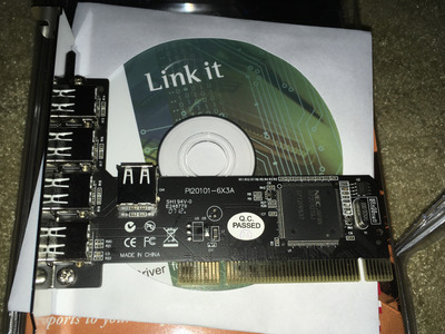

Just jumping on the back of this thread having not had time to read the whole thing (apologies) as I'm failing to get a Link-It / Belkin card to work in my Aopen AX6BC. It has an NEC d720101gj chip.
Basically installing the card in a PCI slot (I tried 2) gives me a blank screen at boot-up. Seeing as the hard drive still make some noises I'm thinking it could be a conflict with the AGP graphics card. It's a GeForce 4 MX420.
Would be grateful for any pointers. 😀

G40 wrote on 2023-05-17, 16:36:Basically installing the card in a PCI slot (I tried 2) gives me a blank screen at boot-up. Seeing as the hard drive still make some noises I'm thinking it could be a conflict with the AGP graphics card. It's a GeForce 4 MX420.
I had a similar issue trying to use the first PCI slot when an AGP card is installed.
Can you try a different PCI slot? or maybe a different video card? What about a PCI video card?
You could also try freeing up resources in the BIOS menu. Disable devices you don't use (Parallel/Serial ports, native USB) and don't assign an IRQ to the video card.
In the resource manager tab set all IRQs and DMAs to PnP unless you're using a particular sound card.

Thank you! All good ideas, I tried everything suggested last night, unfortunately none have solved the issue. The only alternative graphics card I had to hand was a similar MX440 AGP card, but at this stage I'm thinking it probably makes more sense to find another USB 2.0 card...
