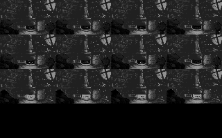

Reply 5 of 12, by taiken7
Heres a work-in-progress view ..
mem a000:0000 (usually final render memory);
not quite what I was expecting,
From analysis of e000:0000 suggests that the EMS is being
used exclusively for audio events (has "creative voice file" signatures)
The page demand also follows audio events rather than video.
Here's hoping they're using page flipping instead of lodsb's ..
there are plenty of those and they'll be trickier to debug.
Will check port 3d5 - function C/D ..
    13.79 KiB
    2279 views
    first pass, 320x200x8bit = masks?!
    8.4 KiB
    2279 views
    Second pass, 80x200x8bit= Stretched mask
    14.46 KiB
    2279 views
    Final pass, using 80x200x32bit->8bit
    (Colour codes the masks)

Reply 8 of 12, by taiken7
I just realised the worst case scenario -- the memory model;
The problem occurs when you mix EMS with graphics (with the VGA PEL Mask (port 3C6h).
What the mask does is grab some free memory and apply masking, finally returning a final image .. that memory was in the middle
of an EMS page! (or at least immediately after the last page accessed)
Not sure how to fix it except to reserve a page or 2
at startup for VGA "scratch" buffer.
(This could also be what causes the VESA 2 problems).
*EDIT* No VGA seems well behaved, it seems to be the *AUDIO BUFFER*
(If you disable audio from the start menu, everything proceeds really well)
So now its just a matter of following up audio side.
