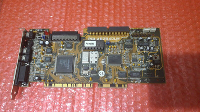

Anyone have any knowledge about this card which I just picked up from Ebay?:

I am planning to use it in a new Dual CPU ASUS P65UP5 build I'm putting together. It features the ASUS Media Bus so I thought why not use it to add some quirkiness to the build 😀
It features SCSI from Adaptec (through PCI bus) and sound from Creative based on the Vibra16S chip (through the ISA bus). It comes with the OPL3 chip and wavetable connector.

Adding new info to my old post as I finally got around to installing and testing this card.
The PCI-AS2940UW is a MediaBus 2.0 card which replaced the similar 1.2 version named PCI-AS7870. It also changed the SCSI chip from 7870 to 7880P. From pictures I've found there are later revisions of the AS2940UW with no OPL3 and the CT2505 Vibra chipset (instead of CT2504 as installed on my card). At some point the card was renamed again as the PCI-AS300, but with the same p/n as the AS2940UW. According to a source in Google Groups this was the longest selling MediaBus card offered by Asus.
I've installed it into my P65UP5 rev 1.41 board and it's not been a pleasant experience. The SCSI part works without issue, but with a Matrox Millennium II installed the computer hard freezes once the sound is enabled. DOS works fine, crashes only happen in Windows 95. So far I've tried the following:

Reply 2 of 18, by dionb
Basically it's as simple as a PCI SCSI card and an ISA (PnP) sound card on the same PCB. What you're hitting here is good old ISA PnP hell, which you almost certainly would have had with a similar Vibra on ISA card too.

I've done more researching into the matter and I've finally gotten to the bottom of it. The issue is not with the MediaBus, but the combination Intel 440FX, Matrox Millennium and the Soundblaster 16.
Before I found the solution I tried the following:
- Updating PCI IDE Bus mastering chipset drivers to latest version
- Update Matrox Millennium video BIOS from v1.0 to v1.5
- Add [mga.drv]PCIChipset=1 to system.ini file
- Disable busmastering on the Matrox Millennium
- Update to the latest Win95 driver for the Adaptec A7880 chipset.
None worked. I then went into the BIOS and just started disabling chipset PCI write options. When I got to "USCW write posting" i finally struck gold. This needs to be disabled.

TLDR: Bug in either 440FX chipset or Matrox Millennium when used in combination with SB16 on "passive release" with USWC write posting BIOS option.
