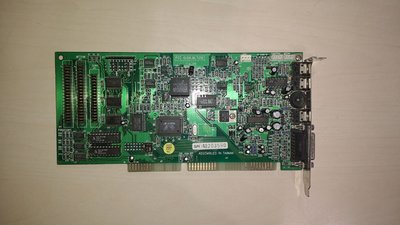

Tried my new old Media Vision Jazz16 out. Oh man..... Was I in for a treat.
I tested the SB-Pro and the Adlib part of this card, and to my surprise, it sounded exactly like what I remember games should sound like around 1993. Perfect blend of treble, bass and middletone for my taste. And it was a warm sound. This card is now my favorite in my collection. I have heard about wavetableheader bug on this model of the card. This makes no difference to me, as this shall only deliver Adlib when it comes to music.
I played DynaBlaster, Lotus and Pinball Fantasis for about an hour. A couple of times I had the same feel as if my PC was an Amiga.

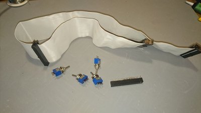

Guess everyone here already seen the innards of a computer and jumper headers a million times, so didn't bother with that. Here's the raw material for the switch panel. A few SPDT switches, an IDE cable, and a 0.10" C/C connector I've salvaged somewhere.

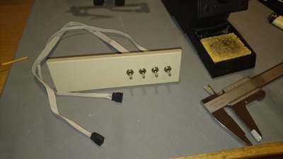

Cut out smaller connectors from the salvaged one, fitting the new pin headers. Prepared leads from the IDE cable, and soldered everything together, some heat shrink tube to cover the solders as a finishing touch. Drilled out holes in a spare white front cover (kept the original one untouched), and tested that everything fitted together.

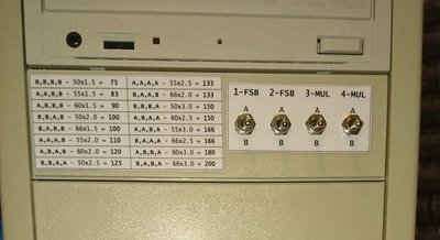

Printed out a table of all possible combinations and corresponding FSB/CPU speeds, and markings for the switches.
It works great! Even though it doesn't match the flexibility and convenience of a K6-II/III-system, it's not that far from it. Flicking a few switches and disabling caches in BIOS ain't all that painful either 😀

Nice 😀 I didn't' see what cpu you are using, but that is such a cool setup. Makes it look like an industrial system.
Reply 4697 of 27716, by kaputnik
It's a Pentium 200, so it's possible to use all settings without overclocking.

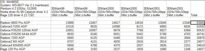

Here are the results of my AGP benchmarks in Win98. I'm not too fancy with charts and such, so no dedicated thread. This was mostly to satisfy my curiosity on Geforce2 MX vs Geforce4 MX4000, FX5200 64-bit vs 128-bit, and FX5200 128-bit vs Geforce 3 Ti200. The others were thrown in because they were available.
