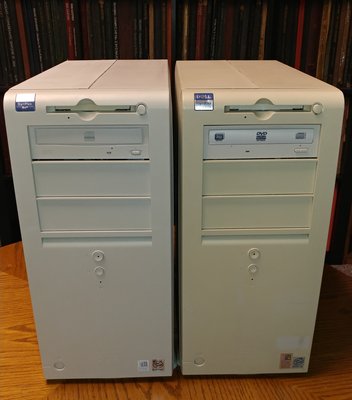

Reply 11516 of 27695, by detritus olentus
Tried retrobrite nonsense using peroxide creme from the salon supply store. I don't think it came out half bad; a little streaking but additional treatments lessen it so I figure a couple more could eliminate them if I felt inclined. GN+ next to a GX110 for color comparison, it used to be more yellowed than the 110.
    544.59 KiB
    1119 views
https://archive.org/details/@detritus_olentus
Philly Burbs.
