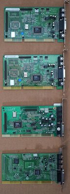

Tested four ISA sound cards tonight on my tech bench Slot 1 motherboard. The top two ESS Audiodrive cards both have a high pitch whine to them in Windows 98SE and are rather noisy (white noise) over headphones. The third ESS Audiodrive card is so noisy with hiss and white noise it is almost unusable. On that third card there is jumper block JP3 and JP4, but I don't have a clue what their settings are. All three have noise artifacts coming from other devices hooked into the motherboard such as hard drive access noise, mouse movement noise, etc. The fourth card is actually my favorite. It has a Crystal chipset and if you look closely towards the rear of the card that's a Crystal CS9236-CL wavetable chip which actually sounds rather incredible with MIDI tunes. It also is the least noisy of the four cards. I vaguely remember ISA sound cards having a slight hiss to them, but some more than others it appears.

I don't know if this is a true statement or not, however, have you used an ATX power supply that has the -5VDC or the ATX to ATX w/ -5VDC adapter to see if that fixes the whine? Could be capacitor issues.

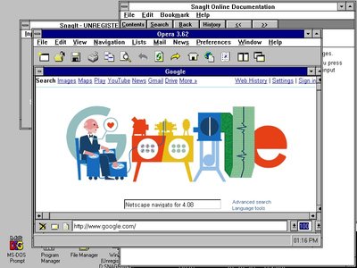

Playing with my 386dx25 running wfw 3.11. Got Opera 3.62 set up and registered. Downloaded IE5 and NS4.08 to compare how they go. Opera renders pages a lot better and is faster. It does pop up an error box every now and again but if you select ignor a couple of times it does recover fine without kicking you out or locking up windows.
Switch both those jumpers over, you will get much better quality output from that 3rd ESS card because that will disable the onboard amplifier (you will obviously need powered speakers or an external headphone amp to use it this way of course)
But I agree, that card based on the crystal chipset looks like a beauty.
Reply 11906 of 19656, by appiah4
Those first two cards look like fine examples of OEM ES1869 cards, they should not be terribly noisy that chipset is fairly integrated and silent. That's strange.
Interesting. I have had the best luck browsing in Windows 3.1 with IE 3.0 or Netscape Navigator 3.04.
Netscape 4.08 works but can be crashy. IE 5 works but is slower.
I tried Opera 3.62 with catastrophic results; it would never really run properly at all and was pretty much useless. This was on a Pentium MMX. I wonder whether the slower computer somehow helps (speed-related bugs).

Reply 11909 of 19656, by liqmat
I was thinking the same thing, but I just don't have time to work on recapping anything right now. I had some noise issues with a few PCI sound cards as well on the same test mobo and PSU so I will mix it up today and see if it improves with a different mobo and PSU.
canthearu wrote:
Thank you! I'll give that a try. That's exactly what it sounds like on the third card down. Like the amp is cranked all the way up on a cheap stereo system. Even when I mute all audio channels in the mixer it's still there. As far as the Crystal card goes I always assumed they were cheap knock-off sound cards, but this particular card changed my mind on that. One of the better wavetable chips I've listened to.
For the first two cards, J6 is a similar jumper. It's from left to right Up, Mute, Down for volume level, it probably defaults to UP. Just jumper the rightmost two pins closed for DOWN and you'll get clear sound from them.
Those cards are Acer OEMs btw, Acer FX-16 to be exact.
Those two jumpers are for amplification on or off. One is for the left channel, the other for the right.

That did the trick on the third card. Thanks a bunch. After all these years of doing this I somehow missed there were jumpers that toggled the internal amp of a sound card. Learn something new all the time in my case. Your suggestion also fixed the Avance Logic sound card I posted about one page back. J4 and J5 on that card disable the very noisy internal amp. It sounds very clean now.
Actually J6 is for remote volume control and mute. Thanks for pointing it out though because it made me investigate deeper and it turns out J5 controls the amp. Much better now so thanks for jump starting my brain.
Yep. you are correct and thanks.
All of you guys have been super helpful and my ears thank you for it!
