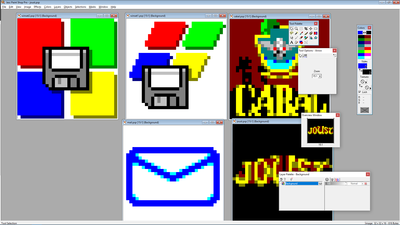

I'm just messing around with a few more icons, for lack of anything else to do.

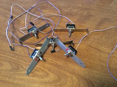

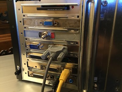

I made some back plate turbo switches and they work great.
I just drilled a hole in these back plate covers and attached the switches.
Later I modified some case power switch wires and screwed them into the turbo switch.
I finished them off with a little solder so they would not come loose.
You can buy these switches and case power switch wires from eBay.
Cost about $1 each to make if you purchase lots of 10
With the Turbo switch enabled I can cut my CPU speed in half.
So 133mhz becomes 66mhz.
And with "Setmul" utility you can reduce that even more. Disabling CPU L1 cache will reduce a 5x86-133mhz CPU to a 386sx-25mhz.
This is great for playing old DOS games that require a slow CPU like "Wing Commander 1"
