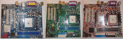

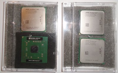

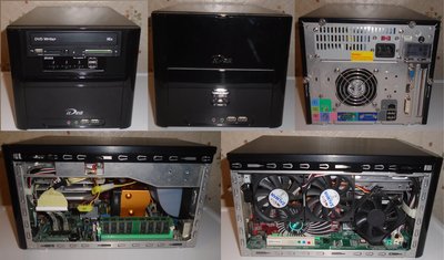

Been cycling my stored socket 754 kit thru some visual inspections and benchmark runs just to check for signs of degradation - thankfully nothing obvious so back to storage.
1.35 MiB
827 views
ASRock K8N68PV-GLAN (Nvidia 7050/630A), Abit KV-85 V2.0 (VIA K8M800 ), Foxconn 760GXK8MC (SiS 760GX/964 )

Biostar iDEQ N1 sff (NVIDIA 6100/410)

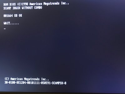

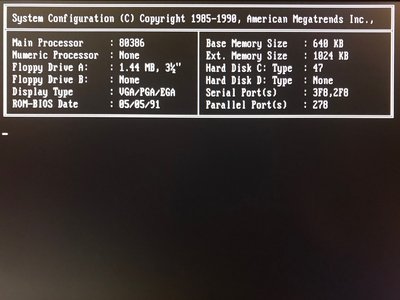

After removing the battery and installing it into the case, the first boot was clean and that was a welcome change of pace from all the headache the previous board proved to be.
1.81 MiB
601 views

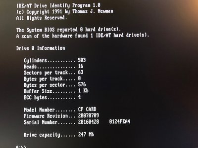

So I went ahead and assembled the computer completely, and found out that the BIOS had no autodetect features for hard drives. Using a GOTEK drive I copied IDEINFO onto a floppy image and ran it.
832.29 KiB
601 views

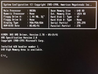

After punching these values into the BIOS it was smooth sailing from there on. Booted an MS-DOS 5.0 install floppy image, and everything went fine.

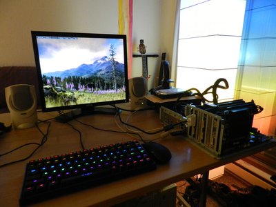

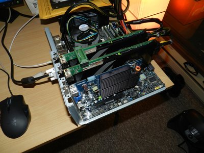

At pretty much the exact opposite of the scale... yesterday night, at probably way later than I should have been doing it, I threw together this test bench out of old case parts and set up the monster system I got the other day:
218.39 KiB
520 views
282.46 KiB
520 views
^^ it came with the two 8800GTs and I had an 8500GT already, so in it went. Because why not?
I set the RAM timings and a slight overclock (5-4-4-15 @ 853 MHz using a 5:4 FSB divider), booted off the previous owner's HDD, waited for the extra cards to be picked up by the driver, set up the SLI configuration, AND...

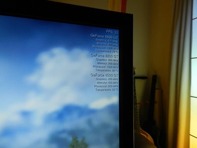

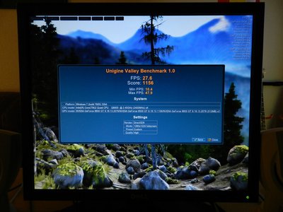

I got to experience SLI for the first time, EVER*! Woooooo!
(* at least, on one of my own machines where i get to mess around and tweak it.)
And... I was actually really impressed. It "just worked", I didn't see any frame stuttering that other people harp on about, and it scaled up smoothly and made a big, solid, performance gain - at least in this one specific benchmark I tried. For a personal introduction to the technology, not bad!
231.77 KiB
520 views
^^ the same machine scored 17.3 FPS & 741 'points' with SLI disabled and PhysX confined to the display GPU.

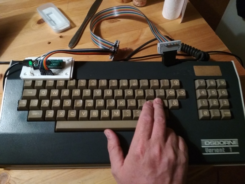

I've decided to teach myself a bit of microelectronics - and what better way to start than with one of the oldest devices I have, an Osborne Variant 1 keyboard:
The Osborne Variant 1 was the desktop version of the famous Osborne 1 luggable CP/M device. I only have the keyboard, so might as well put that to some good use. The interesting thing about this keyboard is that it's entirely passive. Basically the cable contains 8 column and 8 row lines, two NC and two GND and that's it. So what I'm doing here is hooking it up to a Teensy++ 2.0 USB prototyping microcontroller and trying to get it to interpret the scan codes and feed that over USB HID to whatever I hook it up to. This is the 'it's alive' moment when I started getting feedback (for now: lighting that green LED) when I fed +5V over one of the row lines, pressed an appropriate key and had the column (data) line hooked up to the Teensy.
I've now confirmed all keys are working and I have the correct pinout. Now time to wire up all the lines simultaneously and get that Teensy to do what I want with the input.
Btw I know about Soarer's firmware, but I'm not aware of any off-the-shelf version for this old board and I'll learn much more doing the basics myself.

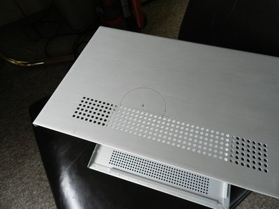

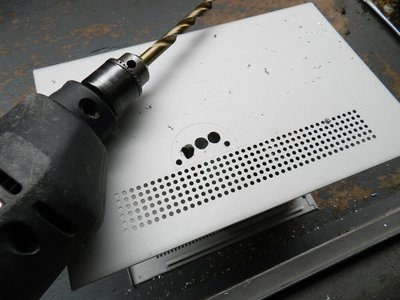

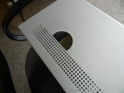

Here's one for Wiretap. Today I decided I needed to make a hole in my favorite mini PC (I really need to update that thread BTW.)
It started like this:
194.36 KiB
409 views
210.94 KiB
409 views
OGOD.

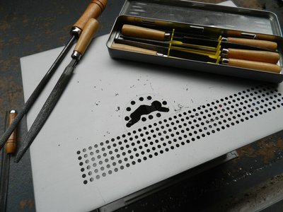

236.17 KiB
409 views
It just gets worse...
Incidentally this was REALLY slow going. Shuttle actually used thick, high-quality aluminum on these. Also, I stole my metal files from a former employer about three jobs ago and they're dull as rocks.
But, after a LOT of patience and meticulous work, which nobody has ever accused me of being good at, this was the result:
196.75 KiB
409 views

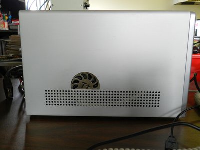

But why did I need to make a hole in that specific spot and this exact shape? Well:
179.31 KiB
409 views
For the GPU fan, of course. Wasn't sure about the look at first, but it's growing on me. And I'd say it turned out pretty well!

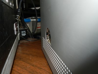

183.92 KiB
409 views
Incidentally, yes, that fan is squished right up against the metal side panel. If it were even 1mm deeper I wouldn't be able to close the case. This worked out pretty well - it takes in air from the outside of the panel, cools the GPU, and exhausts it on the inside, making a physical barrier between the "cool" and "hot" air zones. It also helps channel it over the VRAM chips, which don't run super hot but could probably use the extra cooling anyway.
