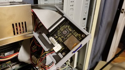

1. 3D printing the SD-IDE bracket a user posted on this forum. It has some issues with the rear screw holes not lining up, but I think that is more on the PCBs not being consistent than the print.

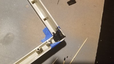

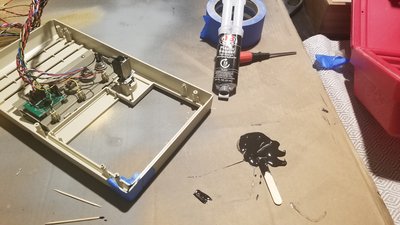

2. I originally purchased some plastic bonder to repair my car's bumper cover. Turns out it works REALLY well fixing cases too. I used a dremel to sand a wide V-groove in the plastic and cleaned it before applying the bonder. I still need to purchase plastic filler and paint to hide the crack (if possible). I could always leave it with a Kintsugi vibe.

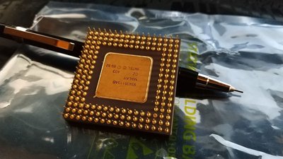

found a good use for my fine pencil today...

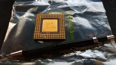

one of the pins was curled over 180°, had to get it out with a knife before I could slide the pencil over to try and wiggle it straight again

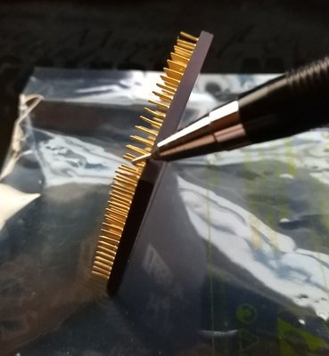

...not perfect... but usable I guess

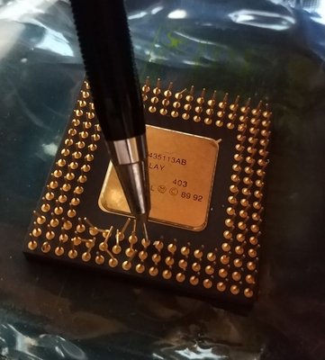

all in all a lot easier than using tweezers

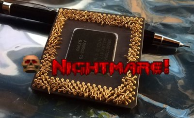

and now...
105.72 KiB
629 views
I am not quite sure yet if I should even bother with this one 😵
I hate what some people are doing to these poor cpus 😢
Reply 12303 of 19656, by wiretap
Most of them were just tossed in a box with 40lb of other crap on top of them, then dug through over the years which causes all the bent pins in weird directions.

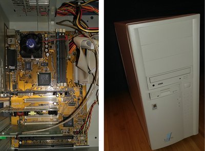

Picked this up at the flea market for a dollar and its hiding a cyrix cpu in a socket 7, a pleasant surprise. Just finished reassembling and it cleaned up nice!

Reply 12313 of 19656, by bjwil1991
Is that a Biostar M5ALA board? That is really cool. And for $1? That's a bargain.

Reply 12315 of 19656, by Mister Xiado
imi wrote:
found a good use for my fine pencil today... […]
If nothing else, you can rescue it from oblivion for bragging rights. I did that with a Pentium 4, and my scummy boss at the repair shop charged the customer for a whole new processor.
Reply 12316 of 19656, by bjwil1991
That poor Pentium 1 75MHz processor. Heck, my 100MHz Pentium 1 pins get slightly bent because I forget that the CPU is on my desk at the moment until I got the heatsink fan to work properly since it was stiff.
