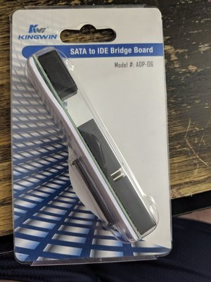

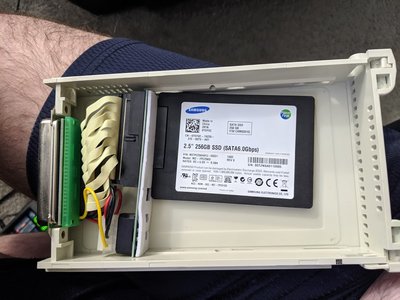

Still running the 486 with the 256GB SSD under Windows 95, even after installing several things, boot time is still the same at around 30 seconds....I might make this my new Win95 setup for the machine. Right now I'm ripping my CD/DVD-RW's needed to run games to Virtual CD-ROM - hey, I have seemingly endless disk space now, so why not. Still hella fast and I've not even loaded the WD VLB IDE Controller chipset drivers yet.

Kingwin ADP-06 I got at Fry's

SSD in RH17 LianLi caddy

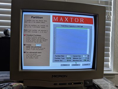

What happens when you put FAT-16 on an SSD, no I did not use this!

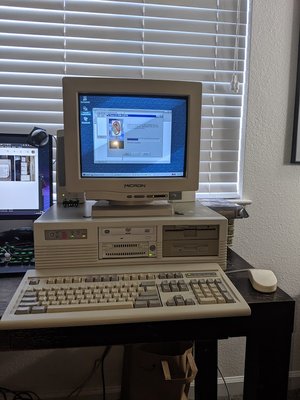

Also, decoupling the DVD-RW from the same IDE channel as the HDD has made a nice improvement in install speeds as well.

Ripping my optical media in VCD

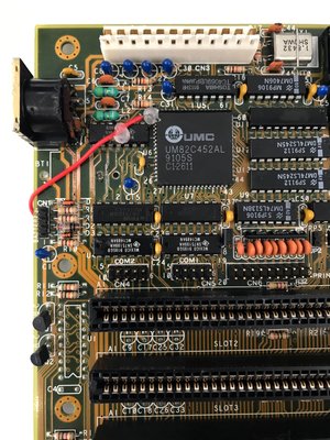

Finally finished testing all traces on my battery damaged 286, and repaired the ones I found. Most issues were near microscoping, so reflowing them by splashing some generous amount of flux and retracing with solder worked, generally. One trace I could not repair by retracing with solder though, so I had to use a botch wire. It was a terrible experience, the solder would just not hold onto the PLCC's leg for some reason, just kept sticking to the iron. It was nothing like soldering THT stuff or botch wires to THT stuff. Eventually I got a bond, it wasn't great, so I fixed it down with hot glue. *shrug* Better than nothing but not ideal. What is the trick to this? What could I be doing wrong?

Anyway, I'll probably test this board tonight. Fingers crossed.

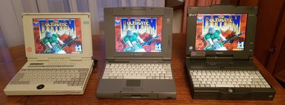

I finally had some time for myself, so I pulled out my DOS laptops (Siemens-Nixdorf PCD-4ND, NEC Versa 4050C, Panasonic CF-41) and run them head to head for a while to check how their screens compare etc. Didn't do much (some time, not a lot of time), but at least felt the pleasure of seeing them working again.
Any suggestions as to DOS titles with atypical resolution / screen modes to test more in depth?

This sounds like a soldering iron that'd not hot enough or not transfering its heat fast enough to the leg to me.

They look really cool. Are games like Doom playable on these or is there too much ghosting from the slow LCD response rate?

No, all of them have active TFT screens - contrast and brightness vary a little, but the response time is very acceptable and games are playable.
