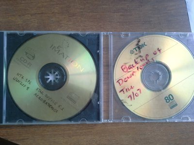

Going through sorting some more treasures. Apparently at one time I was particulaly good at keeping back ups of everything I downloaded.

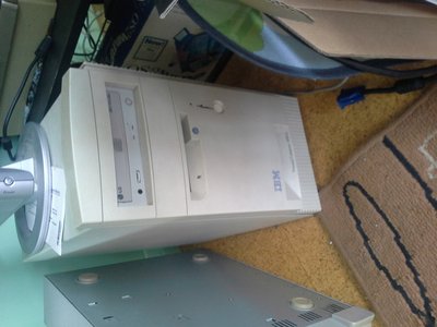

Back then my Windows 98FE box was still the quickest system in the house on the just installed ADSL. The IBM PC300GL mini tower was truely a masterful beast.

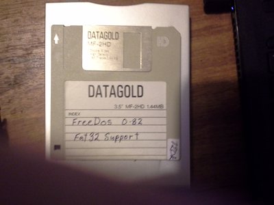

Re-purposed a 1.44 floppy with scratched disk into a 720k floppy.
1.17 MiB
746 views
Edit- The patient booted fine.

Now try the other way around 🤣 just kidding. Good job.

Does this actually work? I thought the media was different in some way, instead of just having less tracks like a DD 5.25 diskette.
Reply 13347 of 19656, by Caluser2000
Just replace the cooky and cover up the HD hole. Very simple really.
Reply 13348 of 19656, by derSammler
No, not very simple. You can not use HD media as DD or DD media as HD. People try that and it often works, but only for a very short time. Data is lost after a few days, or some weeks at most. HD and DD use media that requires different Oersted values to write data to. Wrong Oersted value means that the data is either written too weak (HD as DD), or adjacent tracks getting corrupted while writing a track (DD as HD). That's also why HD drives have an extra sensor for DD media. It's not that they need to know that the disk inserted has only 720k, but to know that they need to switch writing current to match the media.
Reply 13349 of 19656, by Grzyb
The media have different coercivity, but in case of 3.5" disks, not much...
DD = 600-665 Oe
HD = 720-750 Oe
Back in the era, when DD diskettes were cheaper, some people used to drill holes in them, to use them as HD.
Nowadays, when DD diskettes are rare, it's common to do the reverse.
With 5.25" diskettes, however, it's impossible, the difference is much greater:
DD = 300 Oe
HD = 600 Oe

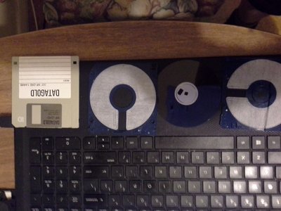

I am NOT using 720k media as 1.44meg madia. I just purely but the 720k cooky in the 1.44meg case just to use it as 720k. That simple. Good cooky replaces bad cooky. Cover up the HD hole so as not to accidently have it try to be formatted as 1.44megs and you have a 720k floppy. Does that help? Here's a pretty picture
1.03 MiB
664 views
During the process of swapping I could have damaged the 720k cooky quite easily. The boot and subsequently testing out various files were functioning correctly verified I hadn't damage said transplanted 720k cooky. Hmmm, now I'm hungry.....

Mag cover disks were always good candidates for this. Your Amiga friends usually had shit loads of them. Soldering irons were the tool of choice if a hole was needed. No messy shards.
