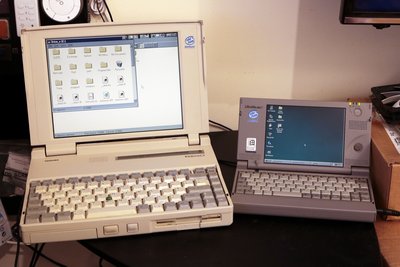

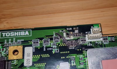

Successfully repaired a Toshiba T4900CT laptop which had the usual battery damage. 😎
1019.67 KiB
412 views
Thankfully the corrosion did not spread through the board, only destroying a couple of traces and some 10 ohm resistors that connect the video chip to what I think is the northbridge. Some soldering later and we have a working laptop again, which is great since I bought this as a working laptop. The seller even refunded me a few quid once I told them that they'd sold this as working but the label on the laptop clearly said it wasn't working.
Here it is with one of its relatives:
819.74 KiB
412 views
I think I now have pretty much all types of the Toshiba laptops from the mid 90s now, everything from the Pentium 75 (Libretto 50CT and T4900CT) onwards, up to early Pentium II (Toshiba Tecra 8000), each one functioning and saved from further corrosion damage. I should start a museum.
