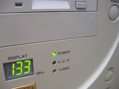

Successfully configured newer MHz Turbo display holding reset button for a while, as instructed by the last post from this threat: MHz display pins
I really hated this display, because I never took enough time to research how to configure it. Now I like it the most, due to it's convenientiality (no jumpers whatsoever).

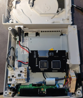

Well, I managed to get my Dreamcast up to almost modern standards. All I need is to add an unnecessary for me HDMI mod somewhere in there.

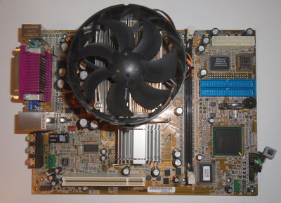

Started the first of what might turn out to be quite a few 'lockdown' builds (some virus thingy or other!), so was cleaning and prepping this board
1.48 MiB
366 views
Any takers for make & (system) model?
