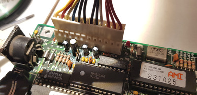

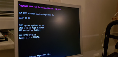

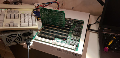

Reply 14526 of 19656, by assasincz
Few weeks ago, I found and ad for a random "PC board" which showed in some rather blurry pictures what I though is a 286/386 baby-AT mainboard, 8-bit ISA VGA and a 16-bit ISA HDD/FDD controller. For equivalent of 14 USD, I decided to investigate.
Picking up the package right before the pandemic broke out, I could see that it is a 286 system running AMD N80L286-16/S CPU. The closest fit to the mainboard is the MINI-AT286 (G2-206) and the GPU appeard to be very similar to this OTI-037 card, all in very nice condition!
Yesterday I decided to test it out. There was a barrel battery which surprisingly did not leak until now, but I desoldered it anyway and in its place put a coin cell battery holder for future LIR2032 3.6V. Nice fit.
I then tested it under power. After switching it on, immediately one of the four tantalum caps near the AT connector blew up - I kind of expected that.
I figured all of them are probably 10uF 16V, so I replaced them with some radial electrolytics I had on hand (3x 10uF 16V, 1x10uF 35V) and tried it again.
...and...success. I am going to have so much fun making a full build out of that...

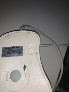

Reply 14533 of 19656, by LewisRaz
Spent way too many hours and 3 different set ups trying to get this mouse to work. No luck.
Seen a few posts on here about mice with this switch but I just cannot get any joy from it. Annoying as my current project only has serial for a mouse.

Reply 14534 of 19656, by derSammler
What mouse drivers did you try? 3 buttons mean it's a Mouse Systems mouse, so you can't use a driver that supports Microsoft mice only.
The switch *may* allow selecting between Mouse Systems and Microsoft, but I wouldn't bet on it.

CuteMouse has a flag for Mouse System mice (ctmouse /M), but, I haven't attempted that before with a 3 button mouse on a serial port. Normally, the toggle switch is for PS/2 and AT (serial with the PS/2 to Serial adapter installed). I have a mouse that has that style switch.
Reply 14536 of 19656, by LewisRaz
derSammler wrote on 2020-03-21, 18:51:
The switch has 2 options "PC" or "MS"
I tried the "standard serial mouse" as well as "microsoft serial mouse" that are part of windows 95.
With both switch settings I cannot get anything from it.

Reply 14537 of 19656, by bjwil1991
There is a driverset in the Windows 95 CD that contains the Mouse Systems driver. I can upload the drivers here for you in case you don't have the CD. Here you go.

Reply 14538 of 19656, by derSammler
LewisRaz wrote on 2020-03-21, 19:01:
That's why I said it may switch between Microsoft and Mouse Systems. I don't know what "PC" is supposed to mean, and "MS" can be either of the two. One setting is Mouse Systems for sure.
Reply 14539 of 19656, by bjwil1991
MS is Mouse Systems, and PC is Serial (PC AT), I believe. I'll test that theory on my 486 with the drivers installed and see what happens.
