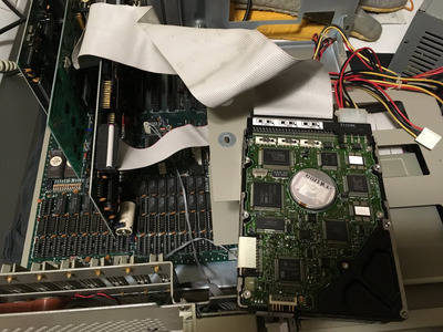

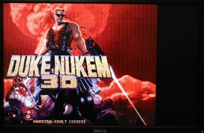

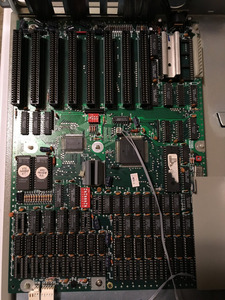

Playing with a Vtech Laser XT/3. The machine came with 640k+512k expanded, a VTCL VGA card and standard VTCL I/O card with 720k 3.5" and 360K 5.25" drives. Plus a DataCannon SCSI adapter (way better than the crappy original RLL card imho) but the Seagate 80Mb SCSI was dead. Installed a 200MB WD SCSI and works well so far. Still need to fix the PSU but am thinking of just swapping in a newer AT PSU board since the paddle switch is a true switch and not some odd lever action thing. Some pics..

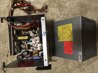

Reply 14556 of 19656, by Horun
A pic of the front and PSU

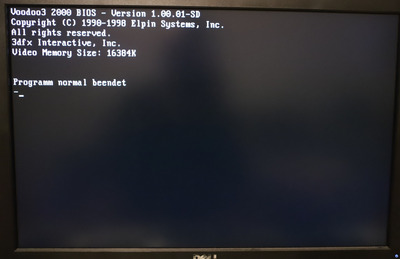

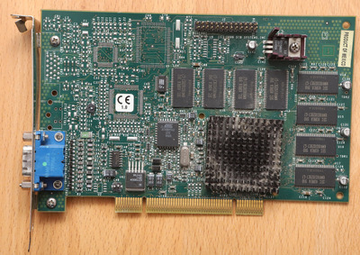

I recently bought this Voodoo 3 PCI as part of a scrap lot...was actually the reason to buy. I was rather disappointed as I saw that the card was in a disastrous condition. Difficult to see on the photos, but it was totally bend and did not even fit in the PCI-slot anymore. 2 Caps missing but this is a minor problem.
I bent it straight again and gave it a try. Totally surprised that the cards powers up and works in text mode without problems. In graphics mode there are some minor display errors most likely caused by bad RAM. Maybe it will be fixed after addiding the missing caps.

Predator99 wrote on 2020-03-22, 08:49:
I can spot 4:
C10
C49
C140
C129
