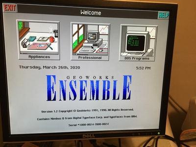

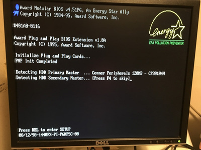

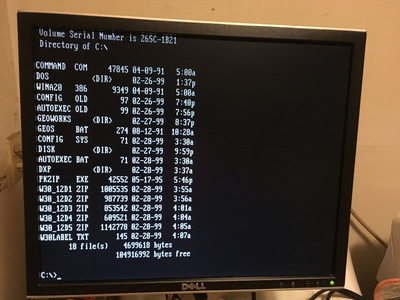

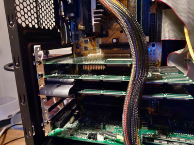

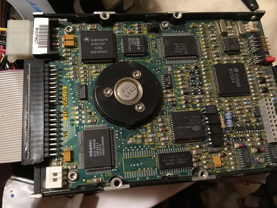

Have some old small drives I want to fix or recycle. Today worked on a 120Mb Conner CP30104, was getting detected but BIOS quickly gave "HD error" and I could hear the HD doing a restart/calibrate every 5-10 seconds. After doing some minor resolder on a couple of the SMT's that appeared to have minor corrosion it booted ! DOS 5 and Geoworks 1.2.
I am horrible at doing any smt work (lack of good gear, bad eyes, bad hands) and amazed it now works. Still some mild corrosion on a bit of the Adaptec interface chip, that was not thee bad one, was the Moto SC80566 microcontroller...

That makes me happy. Glad the HDD is working for you (if only my Quantum Fireball 3.2GB HDD would format, but the sectors are long gone).
