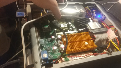

Finally got some time to mess with the iSiS Imagestream TransPort router - had to finagle up a USB connector and connect a Geforce 6200 so I can have VGA output. Still, not too bad. The device has a 10 pin VGA header but I'll need to order a PC104 VGA cable from overseas to use the onboard Cyberblade i1.
775.31 KiB
631 views
Geforce on a router? why not...
762.34 KiB
631 views
VGA header and USB port

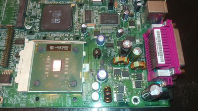

Eh, back to the busted t5720 board. Looks like something is very wrong with the power plane and possibly other problems - the SiS Mirage onboard graphics is conflicting with the ACPI in every OS I tried it on, the VT6107 NIC is showing up as all fs on the BIOS system info screen, and is failing to work. Spent half an evening looking for compatible caps on Digikey, and ordered a batch of them for potential recapping. See if you can spot the bad/bulging cap on the board.
277.1 KiB
631 views
t5720 motherboard
916.5 KiB
631 views
Bulging cap

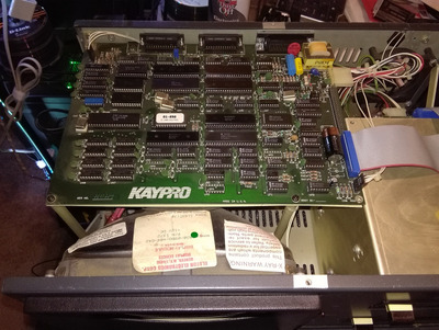

Just the pic, note the battery (26 or 27 years old):
571.01 KiB
490 views
Also despite the fact that it was supposed to have been purchased *used* in 1983, it's definitely a 4/84. The BIOS is also labeled with a 4/84 code but the chip itself is a 32k chip, which means earlier. It has the pin headers for HDD on J9, which would seem to mean 4/84 with a late board.
These things really were made from whatever parts were laying around, weren't they?
All those tantalums make me a little nervous, tho.
Hoping to replace the BIOS with KayPlus and then maybe see if I can get or make a KayFreHD... which I still need to learn more about. There are some PiZero drive emulators floating around, but not I think for MFM drives.

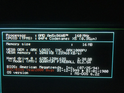

I’ve finally gotten my “fast” 486 to work. There’s a lot of tweaking to be done and a lot of cosmetic stuff needed - I really want to find a fancy case for this). But it works!
Right now it uses an AMD 5x86 at 160 MHz, 16MB of RAM and an Ark Logic ARK1000VL VLB videocard.
1.64 MiB
481 views
1.44 MiB
481 views

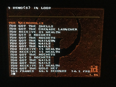

Some might find it in bad taste to overclock a 486 (let alone use a 5x86 on a VLB system), but once I got my hands on the Ark Logic, I really wanted to push it a bit further. And looking at the benchmarks I think the system is pretty stable at 40MHz.
1.56 MiB
481 views
Descent feels very playable with this configuration, as is Duke Nukem. I can even see someone playing Quake at 14FPS back in the day.
The motherboard is QDI V4P895GRN/SMT v1.1 with an Opti 895 chipset and 256 L2 cache. Really love this board — it does everything I need short of supporting EDO RAM and correctly identifying the 5x86 in the POST screen.
This is the first time I’ve overclocked a retro system (let alone a 486), so I’m a bit worried whether I’m risking killing the machine. I know that 5x86 at 160 is a very popular overclock, but what can I lose in worst case? The CPU itself is kind of expandable (I have a few spare 5x86 lying around), but the mobo and videocard are not. Could anybody please comment on this?

Yes, it's a risk, but: cooling. Measure temps, add heatsinks and fans, measure temps again.
