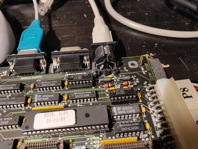

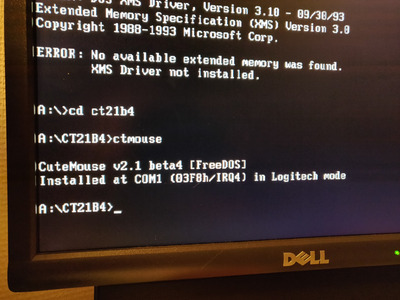

My Tulip AT Compact(s) (NEAT chipset 286) 3 is/are proving to be a nice project. I own two of these systems, both with their own problems. I decided to combine them into one.
One mainboard is 'dead', it does not POST. The other seemed to be okay, but some tantals exploded when powering it up (I posted before)... After replacing them all seemed okay.
I could not get a serial mouse working... I tried an external loopback plug, but tests failed. After some visual inspection and datasheet reading, I think the DS1488N chips are fried. They have some visible damage on top (a little bit visible in the picture), possibly/maybe as a result of the tantals blowing up? Or they were the cause... We'll find out when I replace them. Desoldered them today and put in sockets... Spares should be here on saturday, I found a cheap local seller.
New(OS) chips arrived today! And....
1.87 MiB
537 views
Success!

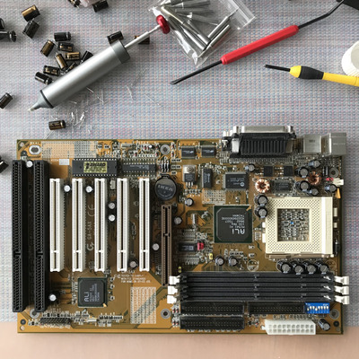

Nice. What are the tools used?
The solder pick I got ages ago from Radio Shack when I was living in the US. The solder sucker is Engineer SS-02 (made in Japan) and it's very nice, much nicer than the cheap junk that is common on eBay. My soldering iron (not shown) is A-BF GS90D: this is a thermostatic soldering iron, very well made, I've been using it for the past 5 years without any trouble.
Thanks ! Will look into that solder sucker, looks much better than the cheap one I have.

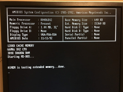

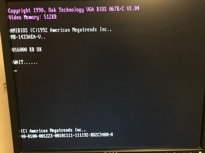

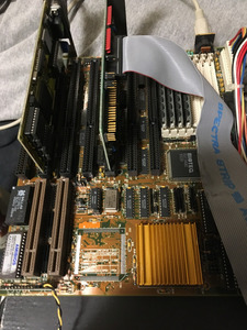

Worked on a couple of old boards that were quirky. The Bioteq/Biostar 1433AEA was giving the most bootable issues, got it sorted so now it gets a green sticker (I put blue for perfect, green for good, yellow for quirky and red for not working stickers on my parts, helps me go back to trouble shoot those that need work. Just my odd way of labeling stuff for a quick visual). Did not tweak BIOS yet, was more concerned about the ram and cache working....
