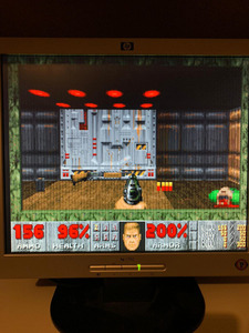

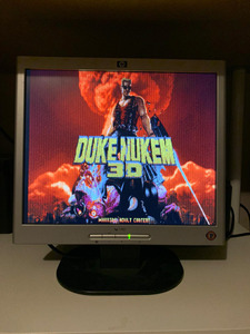

Spent the last few evenings gaming on my 486sx50. Really enjoying this machine and seeing what it can do.
I have noticed this banding in certain resolutions with this vga card. The issue remains on the 3 systems I have tested it on.
Has anyone seen this before?

Ahhh... Spaghetti lines... The monitor inerpret the signal incorrectly and tries to compensate.
What you need, is eighter a CRT monitor or a GFX card with a better output.
These lines tends to show up, mostly on ISA and VLB vcards, however I have seen it with PCI as well.

Ah thankyou! The card is infact ISA!
I do have a CRT but this pc is merely an occasional interest so my "main" rig uses that 😀

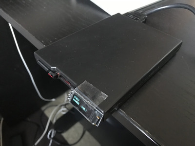

Discovered that the standard/default soldering tip on the Weller soldering station is really too wide to work on small electronic boards. I had to solder 4 header pins on the OLED board for the Thinkpad Gotek and it was a royal pain trying to put a blob of solder precisely on the pins that I needed. Well, at least it works.
1.11 MiB
199 views
Done
Once the Gotek display was sorted out, managed to mess around with a few old OSes being tested on a pile of SD cards via the “open” Thinkpad 560E - none of the old UNIX installs work (AIX/PS2 is looking for a token ring card, AT&T SVr4 doesn’t boot) but got NT 3.51 installed. The Trident Providia worked but the ESS Audiodrive didn’t. Made the mistake of pulling the SD card (formatted to an ancient NTFS version) and putting it on my modern Win10 machine so I can copy some files over...eh, that for some reason corrupted the file system. Might need to reinstall on FAT32 the next time around.

Is this a Trident card? They tend to do that on TFT panels..

Yes it is indeed a trident 8900C.

Duke3D is on the limit of what you might tolerate. Doom is very playable however. I also tested simcity 2000 which crashed after around an hour after becoming sluggish. And Transport tycoon deluxe which struggled with scrolling around the map but was playable. I would easily have tolerated the performance of TTD and doom back in the day, but not duke3d.

Known issue with no workaround, use a CRT or another card.. Sorry. 8900 is a fast card and I have one with 1MB RAM too, but the same issue prohibits me from using it..
