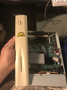

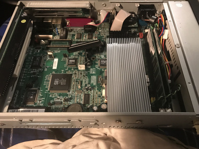

derSammler wrote on 2020-06-06, 09:37:
It does.
But judging from the pictures, a Voodoo2 will not fit in there anyway.
Yes it will. The chassis has a removable metal flap for the PCI slot (the plastic slot on the front was used for an optional Igel Smartcard reader) so there's room to fit it.
582.41 KiB
1744 views
Plenty of room if you are willing...
I am also not opposed to using a Dremel on the plastic bezel if needed be.
1.28 MiB
1744 views
Crappy Igel plastic bezel
