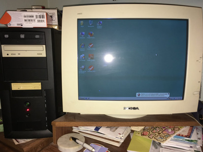

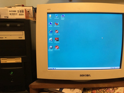

Back track history to about 2008: gave my parents one of my Nokia 446XS crt monitor (bought new in 1997) and a newer computer. Their old monitor was a 14" and old computer was having issues, figured they would like the bigger screen and faster computer, and they did. Back to present: So after fixing the internet issue my mom told me I can have the old crt monitor and computer back as she "had not used it since you got me the HP a few years ago AND the old computer would not start proper". Good news is they both still work (old monitor and old computer). Had setup a dual boot with two HD and one drive was failing so forced boot off the second HD and all seems good. The Nokia has some moir issues at lower Windows resolutions and is not as sharp image as could be but overall works just fine considering the age. The old computer has a Intel e6600 on a MSI P6N-SLI board and seems to work OK so far. Glad she offered them back instead of donating them away where the crt would end up gone forever (recyclers cannot sell or give away anything crt based here, they are destroyed). A few pics, under her office lightning and with flash..and don't give me grief about the white floppy and cd in a black case 🤣

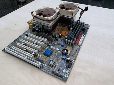

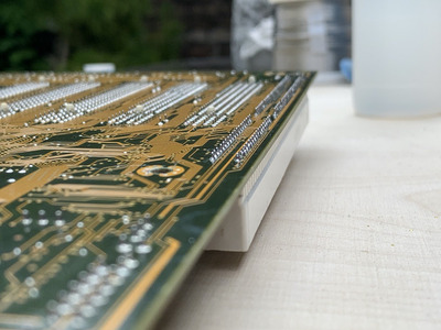

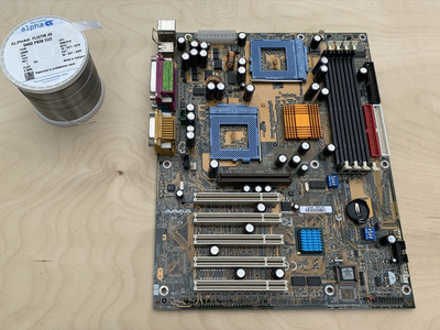

Today I finished the preparation of my dual king board for my take on my ultimate DOS/W98SE/XP tripple boot system…
After desoldering the last couple of pads I soldered in an ISA AT-BUS. The voltages are in check, I couldn’t measure any shorts… fingers crossed… will test with an CT4520 in the next couple of days…

I would love to see that. Is it a Gigabyte board? I see it has pads for a second BIOS ROM chip.

Yes, it's a Gigabyte GA-6VTXD Rev 1.0 from September 2001... I'll try to build this system with an AWE Gold, a V5 5500 and an USB 2.0 card.

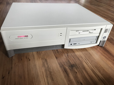

Today I took care of Compaq Prolinea 575e I bought last week. Intel Pentium 75, 8 MB RAM, Cirrus Logic SVGA, DOS 6.22+Windows 3.1.
I have added a CD drive to it (some Sony x24 so it's quite matches the era). This PC has some drive mount brackets to mount the CD, I didn't had one so needed to improvise and use some screws hacking. It's not perfect (there is a little hole when looking from the side), but it fits solid.
Also replaced the Sony MFP520 floppy disk drive with Sony MFP920. Needed to remove some parts of the FDD case and swap some plastics, but fortunately those drives are very similar and everything has fit from the broken one.
Finally, I have added the ISA sound card - this time I decided to use CMedia SoundPro CMI8330. I only need to install drivers for it.

The last picture is a beauty. I see you bought best possible fans for cooling. I hope ISA bus will work.

Yes, these fans are a very good. I use the low noise adapters (~50Ohms). Together with the copper coolers from Thermaltake they’re really silent and efficient.

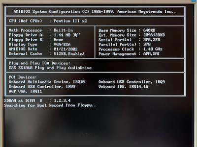

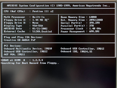

Follow up on my dual king ISA slot project … SUCCESS
After several theoretical tests, checking for shorts, checking voltages and continuity tracing of all 98 contacts I started live testing today.
I used several different sound cards because some make use of different power supply contacts on the ISA AT bus (-12, -5, 5, 12 (V)). I also tested PnP and non PnP cards.
These included an ES1868, CT1740, CT2230, CT4500 and CT4390 … I didn’t run into any limitations, yet. Now, let the real test commence - GAMES...
