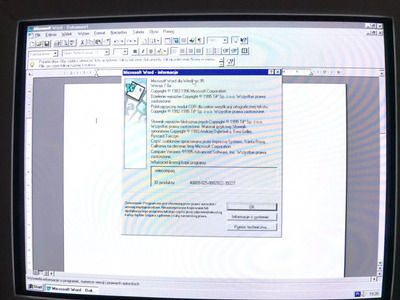

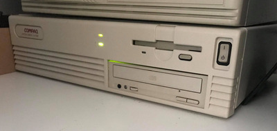

Today I have spent some time on my Compaq Prolinea 4/66 I bought a half year ago (that's a different machine than in previous post). Intel 486DX-66, 16 MB RAM, Tseng ET4000/W.
185.24 KiB
1624 views
I have added CD drive for it. Didn't had any low speed one, so I decided to mount standard x52 and set the speed with some DOS and Windows tools. Removed some "52x speed" markings with a little bit of acetone. I won't do that on valuable hardware, anyway this CD is for price of ice cream. Now it looks like the original part and it is quiet.
Installed PS2Rate and change default choppy 40 Hz to 100 Hz. Now the mouse cursor is super smooth.
Installed some drivers for Aztech soundcard (that was painful, it was hard to download right ones) and better Tseng ET4000/W drivers by MicroLabs. Also installed some software I remember from my dad's PC from the 90s.
This build is so slow for Windows 95... But it has to be. That's how my dad's PC was. 😁

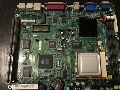

Been a busy last week - finally figured out DDMA on the Igel Winterminal-J (Winnet IV). It turns out that deactivating delayed PCI operation disables DDMA on the southbridge. I also stripped down the thin client to its bare minimums to do a what-do-ya-know on the hardware.
886.85 KiB
1535 views
Winnet IV motherboard details

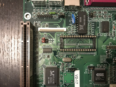

And what do ya know, going through the motherboard manual there were an issue on a hard coded setting accessing the M-Systems DiskOnChip module (which was removed...it was supposed to emulate a custom ROM by implementing a 64k sliding window to its own address space via an upper memory block) I had to set it so it does not overlap access space with the D000 address needed by ESS to implement its DDMA. Once the DOC address was changed on the jumpers and DDMA turned on, SFX worked perfectly. The Solo-1 embedded onboard works fine now. Had to make sure that the embedded Solo is enabled via the jumper, and the Realtek RTL8139 is disabled. On the right side of the ESS1938S there is a 4 pin connector labeled MIT1...my guess is...Mitsumi CD audio interface? I’ll need to do a continuity test with the 2 side pins and pins 37 and 38 on the ES1938S itself (37 and 38 are Aux-A left and right, respectively,
915.66 KiB
1535 views
Using c800, with the DOC stripped, and NIC disabled

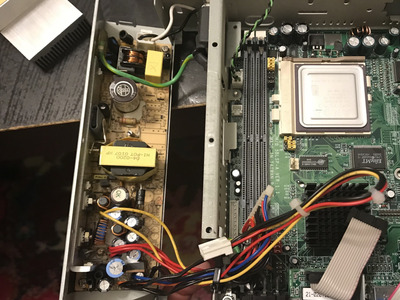

The next one is to look at the PSU details - looks clean, the caps are all in decent condition...rather important as it is passively cooled (the fan grate does not contain a fan).
671.25 KiB
1535 views
PSU details

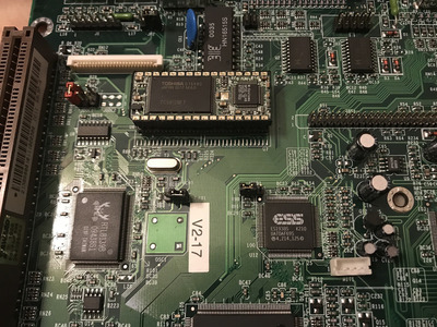

The 2x256MB 16 chip “low density” RAM (the same kind used in Intel 440 machines) arrived and was successfully recognized. This does make it easier to load ISOs into RAM and map them into virtual
939.4 KiB
1535 views
Default (using d000) on the red jumper
drives in DOS. Not sure if I can toss a 512MB unit in there to get 768...I might have a unit I can borrow from my Cobalt Qube 3 Pro (that machine has 2x512 MB).

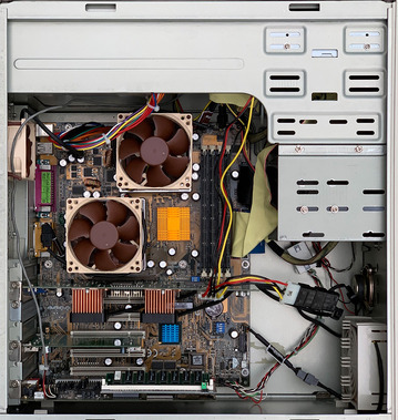

Assembled my dual king project yesterday evening. Only some minor changes to be done like tidying up the cables…

But there are some things I’d like to change in the future:
1. A 3D printed airflow channel for the Voodoo5 (taking up only one but not two PCI slots)
2. A different USB 2.0 card with NEC controller (the one used is hogging three interrupts)
Does anyone know of an available USB-2.0-PCI-card with at least 2 ports which requires fewer interrupts while still working within DOS 6.22, Win98SE and WinXP? (I know there’s a thread, but it is six years old … Belkin seems to be available but I could not find any validated evidence of it using fewer IRQs.)

I am a simple man. I see a system with 2 cpu's, I get happy. I could nitpick about cable routing, but unless you have a window on the case, its a moot issue.
But to answer your questions/concerns:
1: Do yourself a favor and cut out the fan holes in the rear of the case. Get a proper size hole saw and just remove ALL that metal blocking the airflow. You can buy wire fangaurd. That is going to do more to improve temps than anything else. Also, why is 1 exaust port without a fan?
2: I just did a quick ebay search for "nec usb 2.0" And got 90+ results. Just pick a card that looks nice, AND doesn't come from china. 9/10 of my ebay searches I eliminate china as a source, for hopefully obvious reasons. Also be careful of the chinese dummy sellers that are local. When in doubt, buy a name brand. syba, siig, rosewill, belkin, etc. I looked at ebay germany and item number 253908153006 strikes me as card i'd pay money for (if I didnt already have a dozen usb cards).

Yes, thanks, you're right it is still quite easy to find USB 2.0 PCI cards but do they use fewer than three IRQs? The one I use has the typical 4+1 configuration, works under MS DOS 6.22, Win98SE and WinXP but it uses 3 IRQs.

I've never cared about usb in a DOS environment.
Also 3 irq does not seem correct. Maybe 1 physical irq and 2 logical? I can see that. Maybe it's using more irq because it has more base ports.
Try a 2-port. Worst case scenario, you need a hub.
