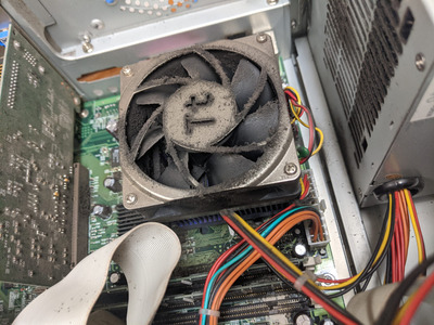

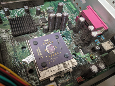

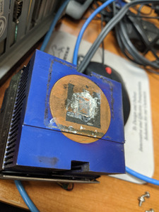

Started cleaning up an old PC I upgraded for a customer. It was in a machine shop and the stuff on it isn't just dust - it's dried, crunchy, machine-oil grease stuff (similar to what you'd find in the engine bay of a vehicle). Not sure on the best way to clean the board; any thoughts? CRC Electra-Kleen? DeOxit?

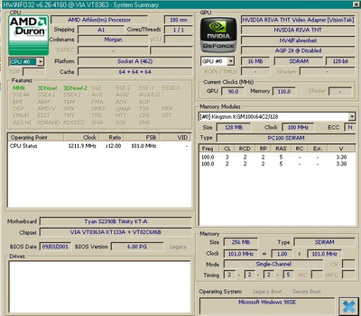

Duron 1200 with a TNT? Now that’s strange..
Definitely was a WEIRDLY cobbled together machine. Seagate 7200.10 80 GB PATA drive, RIVA TNT AGP, Duron 1200, 256MB SDRAM (2x128), and Windows 98. Onboard serial and parallel ports disabled with a PCI serial/parallel card installed. No sound card whatsoever.
Reply 15969 of 27625, by PcBytes
IBM had Vanta cards in some of their Netvista P4 machines, so not so surprising.
For this greasy, gritty stuff, use eviroment-friendly engine bay cleaner mixed with bit of water in a large tub, put all this disassembled parts in that tub, brush them clean with stiff natural bristle brush including heatsink except fan, throw away that fan and replace with a delta or NMB or Nidec with 4 pin PWM fan from ebay.
Then rinse out with warm water and soap then, rinse 3 times with warm water in a tub. Then pour 99% alcohol (this takes excess water with it and evaporates quicker), over the boards and let it drip off. Let it dry naturally.

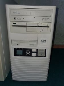

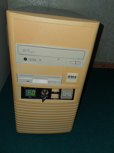

I did retrobright on my 486 PC.
What mixing percentage and process did you use.
It’s summer and very hot in California right now and there are some cases I would like to restore.
Great Job! That turned out awesome. What Method did you use?
I used oxidizing emulsion cream for hair vol.40 (contains 12% hydrogen peroxide), stretch wrap and the sun light. I left it in the sun all day.
That is much better . I don't mind a bit of yellowing, personally and I actually like darker shades of brown, but that middle ground was not very appealing . The end result is much better .
