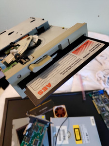

Got a very nice Toshiba drive in today. First 5.25 drive iv ever owned that worked!
Super thrilled to have it, but i think the heads have gone out of align sometime between me getting it, and putting it into my woodgrain 486 🙁
Time to spend the rest of the day figuring out ImageDisk 1.18's alignment program i guess. Its so confusing.

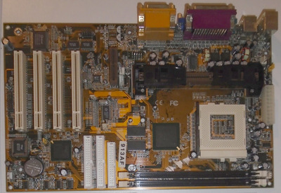

Been having a closer look at a board I picked up last year (went straight into storage after I checked it booted to POST / Setup) - the slightly quirky Jetway 913AF, a combo Slot 1 / Socket 370 (?) board based on the i810E chipset.
https://web.archive.org/web/20000511222844/ht … 913af/913af.htm
482.67 KiB
1174 views
Completed a more thorough check and did a few test OS installs and everything seems fine.
The one slightly weird thing about it is that it only supports jumpered 133MHz fsb booting on Slot 1 (cartridge or sloket up to coppermine 1GHz) but is limited to jumpered 100MHz fsb booting on Socket 370 (up to 1000/100 x 10 or 1000/133 x 7.5 coppermine) then you can adjust the cpu/ram in the bios (I got it as far as 124/124).

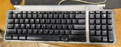

I said screw it, and decided to get my Apple USB Keyboard to look nice again. I'm happy with the result, since it looks sorta new now.

Looks really good. I have a matching one for my Graphite G3/600 since it has a slot loading drive and can be used with the G4/800 Lampshade system. Will get my USB sharing hub connected between the machines to use the keyboard and the Microsoft Optical Wheel Mouse to both of the machines.
Reply 16236 of 27716, by BetaC
bjwil1991 wrote on 2020-07-18, 06:21:
That sounds pretty cool, and I forgot that G3s actually went up that high. My G3 system is a powermac, so i was thinking back down near the 400MHz range.

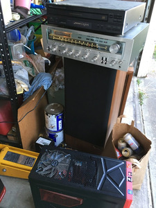

Not PC but fired up my Kenwood KR-8010 today, maybe tomorrow will fire up the KR-9600 or the Technics SA-5760. I collect both old PC and old Stereo gear with Kenwood being my favorite. Have had most of these old things for decades, last item donated to me was a Pioneer CT-F7171 which I have yet to go thru and make running well, he came by and checked today (people donate to me because they know I do not sell, and can come and their old item usually in working order). For speakers pushed it thru some Infinity SM-122 towers (not best acoustically but very efficient), thought about the Yamaha's or Japan made S series 5 ways but they need crossover rebuilds. Ok so not PC but thought I would share. I remember someone here posting about fixing an old belt drive turntable years ago and was impressed. Yeah garage is a mess a lately...
