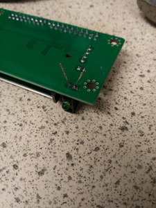

Today I replaced the blown activity LED on the CF-IDE adapter from my 486. Not necessary to operate it of course, but stuff like that bugs me. Quite proud of this, normally I hesitate to tackle soldering that's on a smaller scale than, say, trailer electrics.

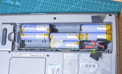

I haven't heard of a charge controller never being able to work again once it senses 0V (or probably lower than 3.5V per cell). If that's really the case, I would temporarily solder a power supply (like a wall wart) onto the charge controller where it senses voltage so you can work on the battery pack separately and just drop it into place.
This battery has bq8011dbt controller and I read some posts about really difficult process of reprogramming it, due to missing datasheet. So I wanted to be careful here, but I don't know if that was really necessary.
I discharged old cells to the same level as new cells (Samsung with pre-soldered tabs, bought that from reputable battery supplier, every cell was 3.5V so probably no fake or used stuff), first I soldered additional "bridge wires" to the old cells and charge controller, so they still were connected even after cutting them off. Unfortunately i broke one bridge wire (positive terminal) while cutting battery tabs, immediately resoldered it and "battery test" light was no longer working... anyway i proceeded with replacement of the cells, soldered new ones, used spare space to solder AWG18 wire to positive terminal and AWG20 to balancing circuit, in other places I managed to use nickel-plated metal strip (i didn't solder to the body of battery but to premade tabs, I don't have spot welder).
It is being charged now with full power, i unplugged AC for a while and it continued working, hope everything will be fine 😀 there is some kapton tape because I didn't want to damage the insulation by excessive heat made by soldering. I put some paper tape on the thermistor, i will glue it with acid-free silicone later. I think I will also use silicone to seal the case, latches are damaged now. There was also some black elastic glue applied before, I think that might have been silicone too.

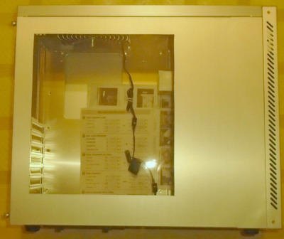

Added a window panel to my new Lian Li case
Love it 😁

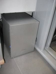

Since I placed my 486 computer on the place where I can enjoy it looks, there was no room left for my secondary working PC. So I've removed the components and installed them in this mini cube PC case and placed it under the table. I had to sacrifice DVD ROM, but I haven't use it very much anyway. I can always use an external one.
