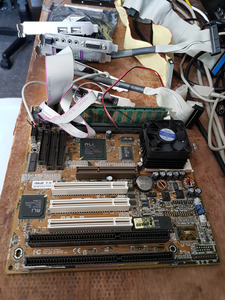

Dug through my loft again today, pulled loads of things out etc and still couldn't find the missing motherboards I'd been looking for. It's now day 3 and I was about to give up, when I decided to look in the place I'd declared "it would never be" and right there on the top there it was, could have found it in 2 minutes flat if I'd looked there earlier! Aaaargh.
So my Super Socket 7 rebuild commences:
728.99 KiB
1396 views
Asus P5A-B (rev 1.04)
128MB RAM
AMD K6-2 500MHz
Voodoo 3 16MB AGP Graphics
Aureal Vortex 2 AU8830A2 PCI Sound
DEC 21140 PCI 100Mb Ethernet
Not sure on HDD size yet, but will run Windows 98SE. I might even throw in an additional ISA sound card for better DOS support.

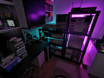

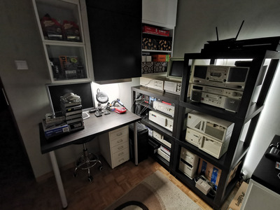

Continued to refurnish my man cave... some IKEA furniture (lack rack FTW 🤣), got rid of really old and ugly bookstand/wall unit... I still need more storage room as the ones on the photos are already filles with ISA/EISA/PCI/AGP cards (tightly packed too) and motherboards fill the another unit behind me (not visible on the photo) and/or I also need to fit a single 15" CRT VGA, I may move the hp LCD 4:3 back to my main desk leaving the small one for building and repairing stuff.

Is that an IKEA table too? Iv been looking for something like that to fit in my small room.
Looks prime for some Woodgrain ;p

Sweet setup HanJammer! I really like the 80's neon.

Yeah, the famous IKEA Lack.

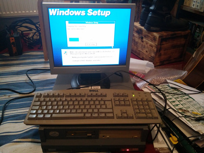

Continued to rebuild my Super Socket 7 PC.
I found a spare Hitachi 82GB IDE HDD, which the BIOS would not recognise unless jumpered to 32GB. So I programmed an EEPROM chip with the later 1011 Beta 005 BIOS for the ASUS P5A-B and that worked a treat, HDD now detected properly, full capacity. I could have simply flashed the original EEPROM on the board, but decided to keep the original chip as a backup.
Also picked out a random temporary 3.5" floppy drive from storage to assist with the setup, which wasn't working at first. So I opened it up and cleaned the heads with a touch of Isopropyl Alcohol, which did the trick. It's only "temporary" as I'm going to swap it with another drive that matches the case colour better.
Finally installed Windows 98 SE & some drivers and that's all for today, I'll start installing games this week.

Nice. Which cpu are you running ?
K6-2 450MHz at the moment. But I'm going to see if the K6-2 500MHz CPU I have will work and swap it, as it's currently being wasted in another Socket 7 system where I have to have it underclocked to 300MHz. An extra 50MHz can't hurt. 🤣

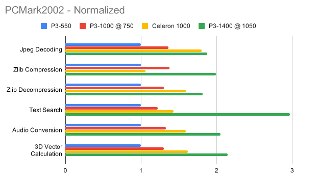

Upgraded my Compaq Deskpro EN SFF with a Tualatin 1400 with built-in interposer from Korea. Of course the chip runs at 1050MHz, being that it's on a 100MHz FSB board. It started out with a Katmai 550 and as an intermediary upgrade I went for a Coppermine Celeron 1000. The Tualatin isn't always 2x as fast as the Katmai, even though the clock speed is basically twice as high - must be that 100MHz FSB. However in some benchmarks that use the cache just right it's extremely fast, as in 5x as fast.
All works fine with the board's VRM, MOSFETs already had heatsink and that doesn't get warm, and its BIOS doesn't complain (though it shows the wrong speed) either.
