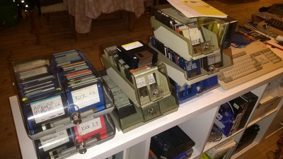

In the process of making backup copies of all my Amiga floppy disks. These are disks from the late 1980's and early 1990's (circa 1987/1992), so I need to preserve the content. For the image backup, I am using an Amiga with HDD and Workbench installed. Running Tracksaver-GUI for the task. So far I am half way through all the disks, only slightly under 300 to go. (two box's are not in the picture)
183.27 KiB
1444 views

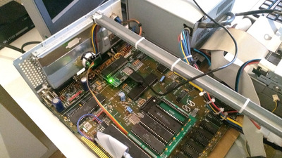

Reply 16499 of 27716, by brostenen
wiretap wrote on 2020-08-24, 11:25:
USB mechanical keyboard mod for my Amiga 2000 -- I still need to hook up the reset pin to the Gary chip, but I need to extend it […]
USB mechanical keyboard mod for my Amiga 2000 -- I still need to hook up the reset pin to the Gary chip, but I need to extend it some to reach since this USB adapter was made for the Amiga 500. And yes, RGB does work on the keyboard. 🤣 So, this is a CIA adapter that I used a USB header to USB Female adapter --> Male to Female USB plate mount adapter --> USB PCI slot adapter to make it have a nice interface on the rear of the case to connect to. No hacking up the case to fit a USB connector somewhere. Just plugging in a USB cable to the USB port on the CIA adapter wouldn't fit because of the Vidiot board sticking up. I suppose you could use a 90 degree adapter, but I didn't have one in my parts bin.
The only thing other than reset which doesn't work at the moment is the # sign. It might just be the keyboard layout needing to be redefined on the Amiga side, or possibly the firmware on the CIA adapter that I need to compile and reflash.
I have the exact same adaptor in my 500-desktop machine. I have the exact same issue with the # sign. Regarding the reset, then you can use the jumper on the adaptor/converter. Changing the keyboard layout from English to Danish did not solve the issue with the # sign for me. Perhaps it is the kickstart version and Workbench version. I am running 3.1.4 and Workbench 3.1.4.1 (yes, the upgrade/bugfix install that solved some issues) I did notice that there are a modules disk for A500, one for A600 and one for A2000 between the ADF files, that are avaliable on the download page, when you register the AmigaOS 3.1.4 at hyperion. Perhaps that will solve the issue, yet that is a test for later, once I am done making ADF backup of all my disks. If you solve the issue, then please give a heads up.
229.97 KiB
1371 views
The picture is from the build process.... I have upgraded the kickstart at a later point....
