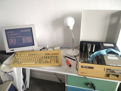

Today I've been attempting to diagnose why my recent Turbo XT acquisition keeps corrupting the HDD when it's in turbo mode... even though the machine has managed to pass multiple different diagnostic tools' testing with flying colours and zero errors.
Investigations are ongoing!

kdr wrote on 2020-09-26, 04:58:
ISA Bus overclock most likely?

Reply 16764 of 27716, by kdr
appiah4 wrote on 2020-09-26, 08:00:
I measured the DMA controller's clock, it's 4Mhz when in turbo mode (and 4.77Mhz in normal mode) so seems within spec.
I guess it's time to start writing a minimal test program that can reproduce the corruption, and then trace through its execution to find out exactly what gets corrupted and how. 😀

Reply 16767 of 27716, by kdr
liqmat wrote on 2020-09-26, 14:02:
Honestly would just try a different/newer MFM controller. Most problems I have run into with MFM tech is a failing cable or controller. Those full metal jacket Seagate MFM drives usually hold up pretty well in my experience. I mean, yeah, I have to tag some bad sectors, but overall they just keep on spinning. Unfortunately I am not near my gear right now otherwise I would send you a couple of newer model MFM controllers for testing.
Whoops, just realized you are in NZ. That would not be cost effective. 🤣
Well the problem is far more sinister than just a bad controller/drive or an overclocked ISA bus...
SpeedStor and SpinRite say that my ST-238R is in perfect condition, not a single bad sector (!!!) or seek error (!). [Yes, while running in turbo mode.] But any access via the DOS/BIOS disk routines provokes corruption on both read and write when in turbo mode. Even worse, it affects the floppy drive too!
This is such an interesting bug that I'm determined to get to the bottom of it! Surely must be some hardware glitch, after all. At least debugging that is a realistic option on a turbo XT clone motherboard (everything is in DIP packages on a plain old double-sided PCB with <10Mhz signals). I'd hate to have to track down a hardware fault on my 486 VLB motherboard, for instance... 😁

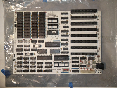

Wow, is that motherboard white ? Can you post a good picture of the motherboard ?
Also: if you did not format that MFM drive with that controller you could have odd issues if formatted with a different but same make/model controller... just a thought.

Reply 16777 of 27716, by kdr
Horun wrote on 2020-09-27, 03:31:
MFM drive had a fresh low-level format, and as mentioned the issue seems to also affect the floppy. I can reproduce it with two different floppy controllers as well. I'm going to write a small test utility to exercise the floppy (far easier to debug because the controller is so simple) and see if I can find a particular bit pattern in the error bytes.
And yes - it is a pure white soldermask on this motherboard! It looks kind of like a NuXT except manufactured in the '80s. Here's a better photo of the entire board.
Reply 16778 of 27716, by SodaSuccubus
kdr wrote on 2020-09-27, 22:05:
That Is a suprisingly clean and modern look for a board made in the 80s. Well done to the folks in the factory that day!
Great find 😀
Reply 16779 of 27716, by Horun
SodaSuccubus wrote on 2020-09-27, 22:30:
Great find 😀
Yes is a great looking board !
