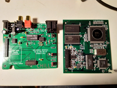

Received mail from Belgium, which means Serdaco stuff 😀
The Chill MIDI interface is back in stock, so snapped one up. After half an hour soldering, I had this:
1.65 MiB
1399 views
Time to externalise my Trust Korg Super Sound module and hook it up to my Roland A-880 😀
Of course I underestimated the size of the board so will have to hack the case for the Chill, but that kind of thing keeps life interesting.

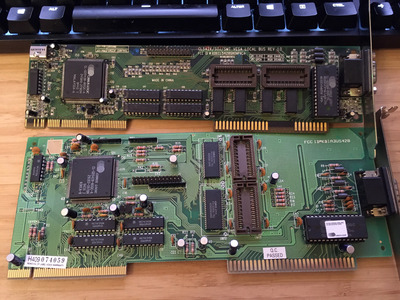

A couple of weeks back I got this untested VLB Cirrus Logic card and finally made time for it today since I've got my big VLB 486 up on the bench.
It didn't work, no video display. 🙁
Then I looked closer, one of the blue capacitors might actually be a tantalum, and it looks crushed. When I removed that it actually looked burned. I put a cheapy electrolytic in its place but it still didn't boot 😒
1.48 MiB
1378 views
But wait, why doesn't this one have a clock crystal? My big VLB 486 has a taller CL-GD5428 card in it so I compared them and looked at some pictures online. They all have the 14.318mhz clock crystal, I guess that datasheet was pretty specific since the designs of other similar cards are all the same.
I borrowed the crystal from my working card and it's working!
Another 14.318mhz crystal (well, 30 of them) is on its way from China 😀

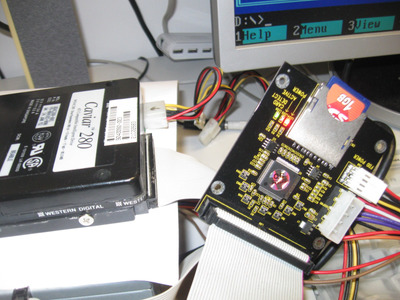

Copying all the files from 81Mb Caviar 280, which was installed in a 286 PC to 1GB SD card. I call this preserving digital history.

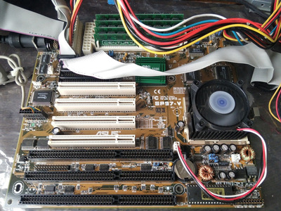

Picked up two of these nice ASUS Socket 7 boards this weekend, both with AMD K6-200Mhz CPUs, one with 64MB (pictured) and the other with 128MB:
501.73 KiB
1234 views
ASUS SP-97V motherboard
This board has two power connectors, one AT and one ATX! So I won't have to consume a valuable AT PSU if I build a system with this board. (And it has three ISA slots, which is very generous when compared to my current Super Socket 7 board's one lone ISA slot, which is just pathetic.)
Includes onboard VGA, which is fine by me since I'm mainly interested in using this one for Pentium-era DOS gaming.

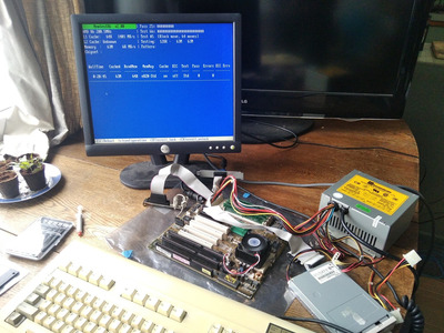

After removal of the tonnes of accumulated dust, cleaning out the heatsink, and applying new thermal paste it is time to boot memtest86:
390.53 KiB
1234 views
memtest86+ 2.00 on a bootable 3.5" floppy
Strangely, this board is unable to boot from my bootable memtest86 CD-R. The BIOS claims to support booting from CD, hmm. I've tried numerous CD-ROM drives that are known to work fine in other systems, but no go. So far that's the only issue -- what a haul!

Nice set of mobo's.
I never run Memtest on cd or usb thumb drive on anything older than soc775... too many quirks. Some versions of Memtest are very hardware specific (ver 4.0 will run on 486 but v4.3 will not). You should use a 1.4Mb 3.5" floppy disk and use the appropriate version for the older hardware you are testing. It is a Pentium board, cannot expect it to work like some soc 115x board 😀

Yep, this is what I'm slowly learning through trial & error: it's always better to find a version of the software that is roughly the same vintage as the hardware...

I use Memtest v4.3.7 on floppy for a lot of Pentium/Pentium 2 era boards. If you cannot find it let me know.

This forum already shared the trial and error conclusions:
Try memtest86+ 4.10
memtest86 that works for 486
