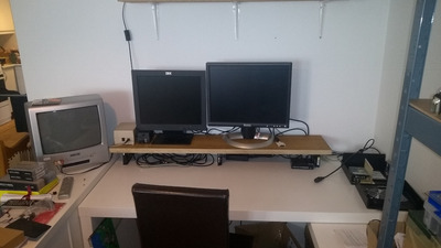

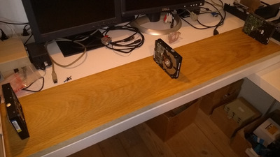

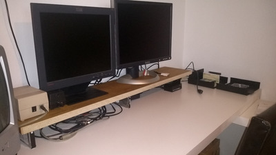

What the F to do with old dead harddrives???? Yup I know what to do. Make a monitor stand for the vintage corner. 😜

To Bancho and Brostenen those are both excellent and creative solutions I love them both.
Thanks.
And it is a woodgrain monitor stand. I think LGR would aprove. 😁

It looks like oak. I personally like the look of wood
Oak is wood... 😉
It is actually chipboard, laminated with 5mm wood of some sort. Painted with some kind of dark stain and some kind of varnish or clear coat on top.
