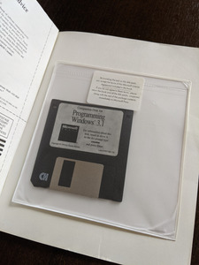

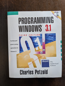

For some reason I have been getting interested in Win 3.1 programming. I used to do a fair bit of Win32 programming back in the second half of the 90's (plain C Win32 and MFC) but never really gave much thought to Win16.
Anyhow, I stumbled on this second hand book online a while ago and ordered it. I had actually forgotten about it since it took so long to arrive but now that its here, the condition it's in is really good. It even has the companion floppy disk and the pouch is still sealed! Love it.

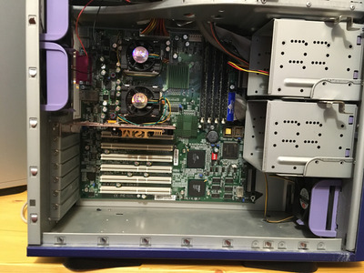

Reply 17252 of 27717, by Vegge

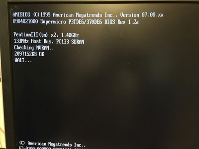

I got another dualbuild booted. I was missing a second cpu for it.
579.59 KiB
1217 views
394.56 KiB
1217 views
No harddrives yet, and OS is undecided.

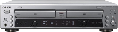

  • Sony RCD-W100 Dual CD Deck
    56.44 KiB
    1169 views
    This one is missing the control knob for the B drive, and it also tended to skip backwards a bit for some reason. I cleaned the lens with alcohol and a Q-Tip. The A drive would eject shortly after closing, which turned out to be because the belt had gone bad. After cannibalising one from my stack of old CD/DVD drives, it works fine. You could say it wants to rock 😜

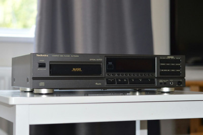

  • Technics SL-PG400A CD Player
    59.39 KiB
    1169 views
    This one didn't even spin up. As it turns out, if the laser doesn't see anything, the motor doesn't start. After cleaning it with alcohol and a Q-Tip, it works fine. It's also surprisingly fast with detecting CDs. What really impressed me with that, is how simple the internals are. It also needed the buttons to be cleaned, but I'll probably end up replacing them anyway. It also sounds a bit more detailed than the Sony one for some reason, can't really put my finger on it. It definitely doesn't fear the reaper 🤣

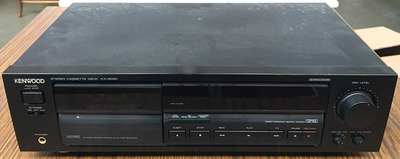

  • Kenwood KX-3030 Cassette Deck
    70.04 KiB
    1169 views
    This one doesn't even eject. It plays like total crap, and it's probably my biggest challenge so far, considering I don't know anything about tape decks. I did give the faceplate a good wash, though, and it looks like brand new now. It probably needs belts and whatnot. Despite my younger age, cassettes have a bit of nostalgic value for me. I used to record CDs and radio programmes to tape as a kid. I still have some of those tapes years later.
